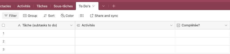

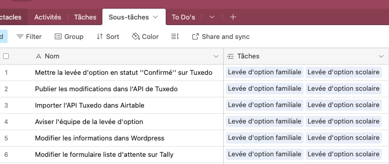

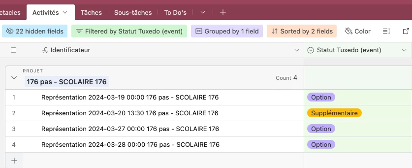

I created 4 tables in my base :
  • Activités (Activities)
  • Tâches (Tasks)
  • Sous-tâches (Subtasks)
  • To Do's
Here's how my base works :
  • In Activités, all our shows are listed and gets one of the following statuses (Confirmé / Option / Supplémentaire)
  • Tâches contains our main tasks and Sous-tâches contains the subtasks. Both are linked.
  • To Do's, would be used to create the lists of tasks. There is a link to the table Activités.
Base on these informations, here's what I would like to achieve by using an automation :
  • In Activités, when an activity with the status Option or Supplémentaire gets the status Confirmé and therefore enters the view ''Représentations confirmées'', create a list of subtasks to complete in the table To Do's (which would be determined by the type of task that appears in the Tâches table).
I attached some screenshots of my base.
