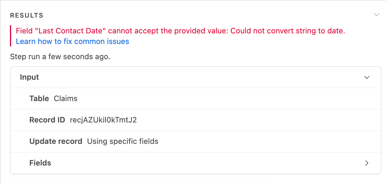

I've just noticed this error message, which I thought might help diagnose the issue.
Forum|alt.badge.img+12
If you use TODAY() in the Last Contact Date field it should work. You may need to change the formatting in the formatting tab of the field to make it look the way you want.
  • Aug 14, 2023 4:46 PM UTC
Thanks again Ron, you cracked it.
