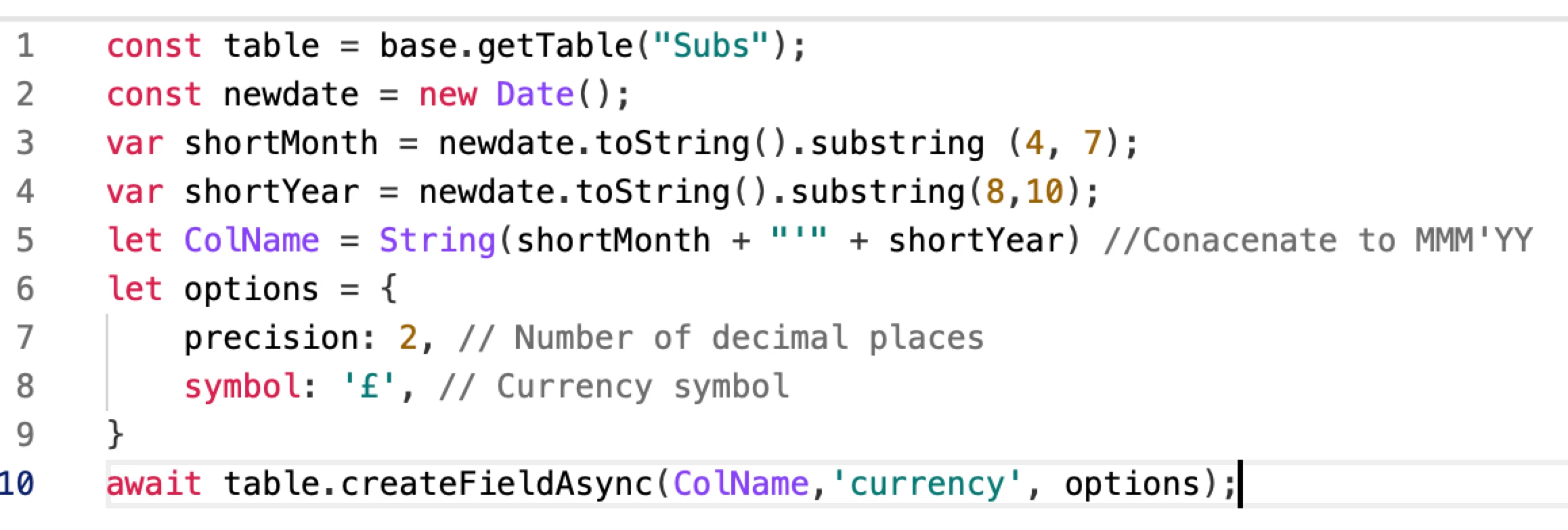

I'm not normally a scripter, but just spent two weeks trying to put this little routine together and make it work. The script calculates the date one year in the future and uses it to rename a new column in the format MMM'YY.  After loads of trial and twice as much error, I actually got in to work!:

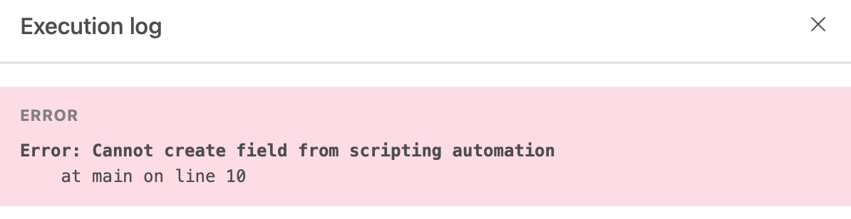

Naturally I was really pleased with myself! Now just to apply a trigger. I want it to run on the first of each month. My first idea was to paste it into an automation. But I soon discovered that scripts run from the automation cannot create fields.
How frustrating! Why not? Can anybody think of a workaround? Is there a command I can put in the script editor to make it trigger on a regular interval?

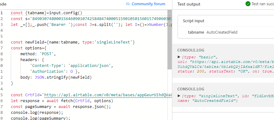

As a workaround you could try calling the API via the automation instead?
Here's the relevant documentation: https://airtable.com/developers/web/api/create-field
The access token with the ability to modify the table schema would be visible to everyone who has access to the base though, and if that's a problem you could use an integration tool like Zapier, IFTT, Make etc to run the script instead

Actually, it works.
But learning to use API is a much harder task than just scripting.
