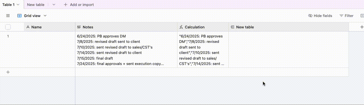

I’ve done that before with the help of ChatGPT. I had it convert the text into a CSV file for me, and then I imported the CSV file into the linked table.
Does this look right?  If so I’ve set it up here for you to check out!
The idea is to split each line in the “Notes” field into its own quoted string, separated by commas, so you can paste the result into a linked record field
SUBSTITUTE(
Notes,'\n', '","'
Kelly_Vorrasi1
Forum|alt.badge.img+9
  • November 5, 2025
So sorry it took me almost a month to see this! This is exactly what I was trying to do but for some reason when I copy/paste nothing happens!
Ah, is the primary field of the linked table a formula field / date field?  That might be the issue
If that’s not the case, if you could private message me a link to your base I could take a look for you!
