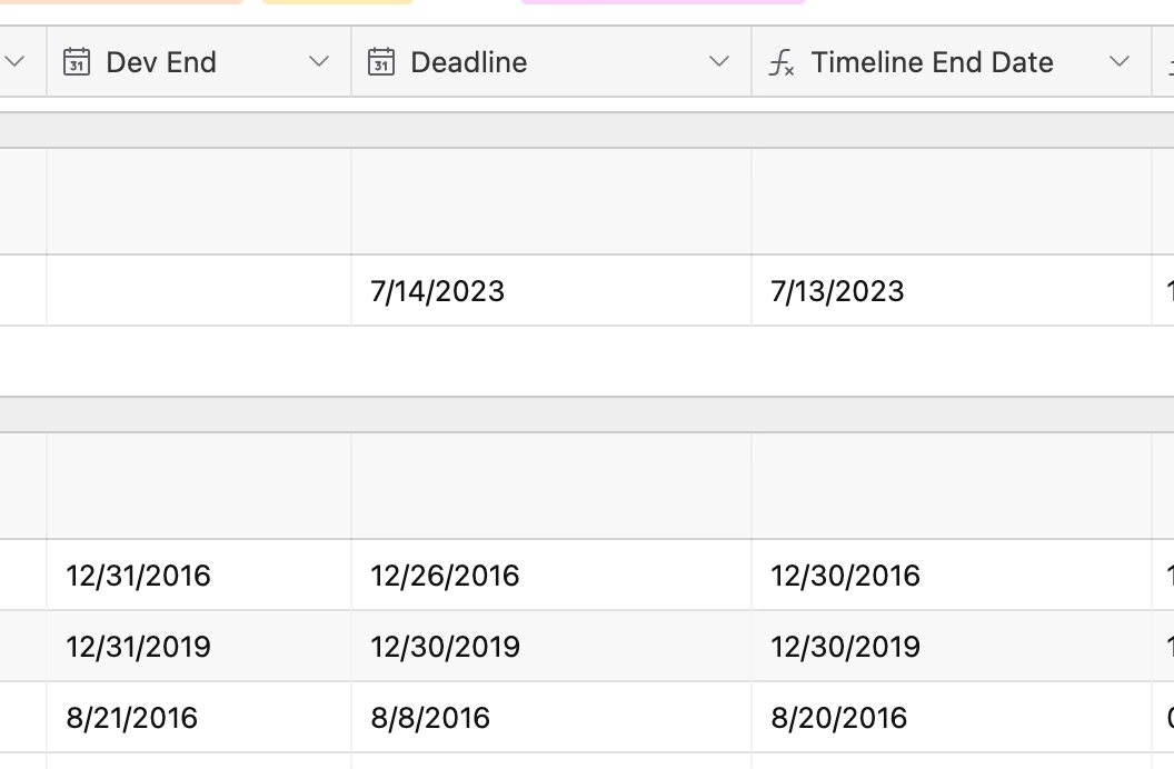

I have two Date fields. I need a third field that simply displays the date in the first field unless it's blank, then displays the date in the second field. Here is the formula I'm using:
IF({Dev End} = '', {Deadline}, {Dev End})

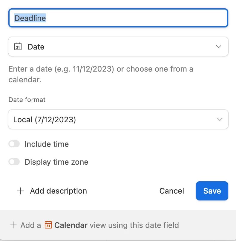

The formatting options for both Date fields and the Formula field are the same:
I'm having two problems. First, the output date in this new Formula field is coming back one day before where it should be. I assume I could just add a day to the result within the formula, but I'm not sure why this happens in the first place. I suspect they have to do with the Time Zone. If I display the time zone, I see GMT, but I can't seem to select my time zone (EDT) unless I also display the time. I'm not interested in the time.

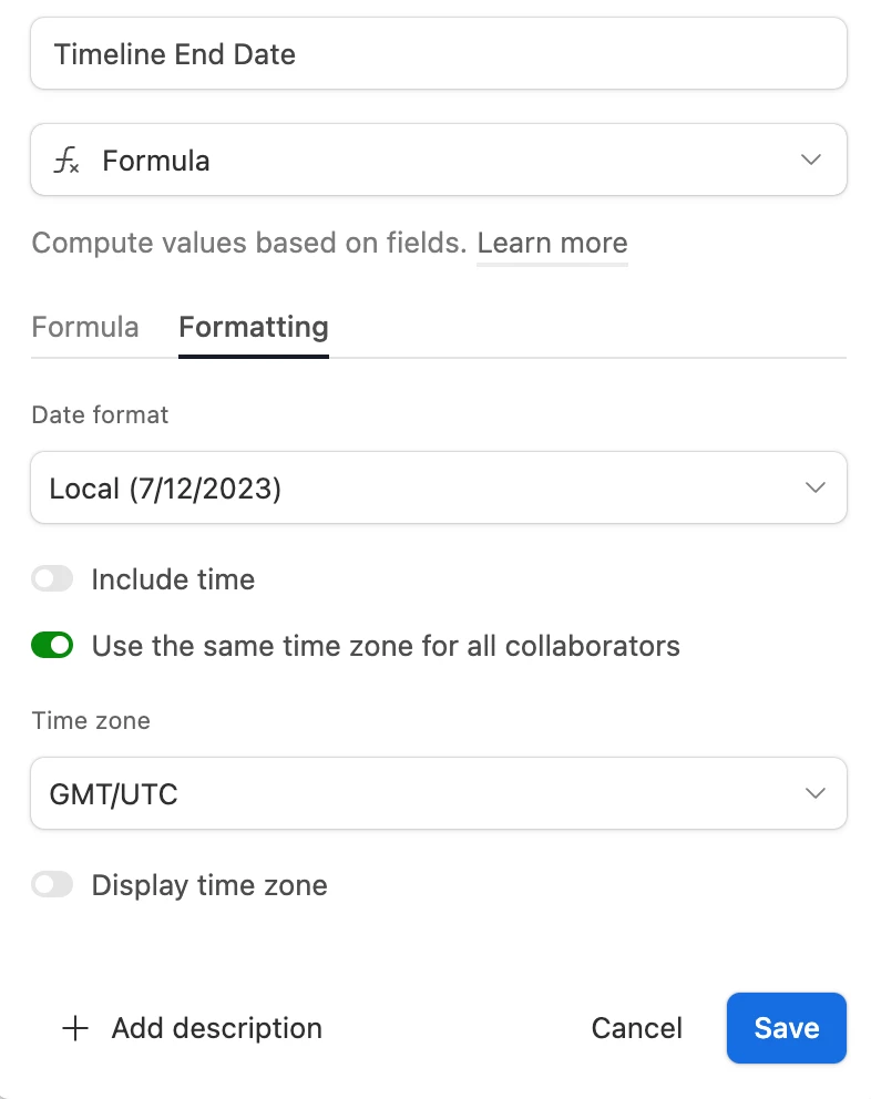

Best answer by Jonathan_Gunne1
I think I solved this... For the Formula field, I turned on "use the same time zone..." and set it to GMT. This is easier than manually setting all of my Date fields to my actual time zone. It seems like it would be nice to set a default time zone for an entire base rather than each Date field defaulting to GMT regardless of your location.
Forum|alt.badge.img+9
