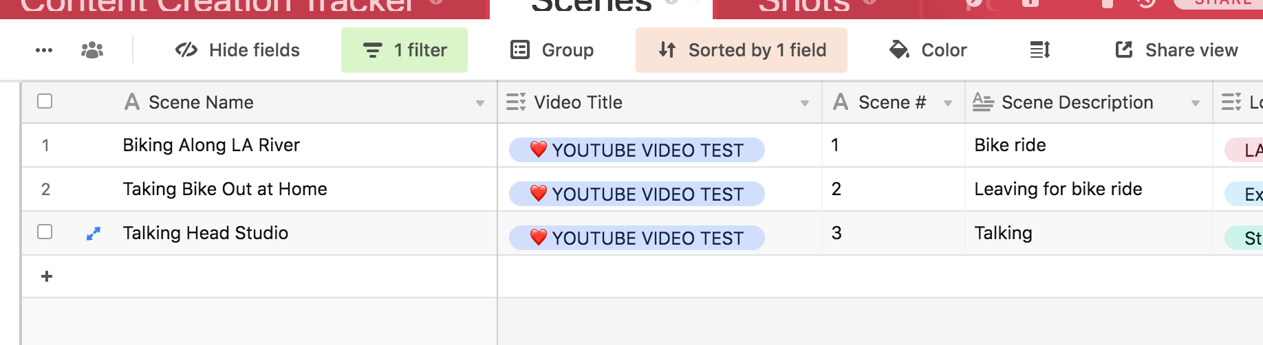

I have a Scenes Table with records listing each scene (Scene Name) to be shot for a video (Video Title).

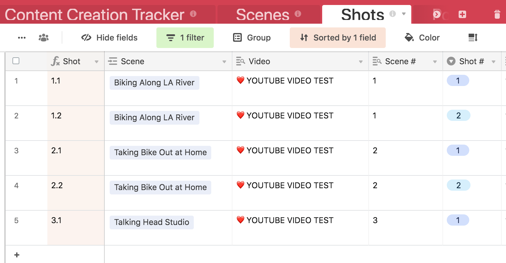

Once the Scene Names are all listed they go to a Shots Table where shots for each scene are created.

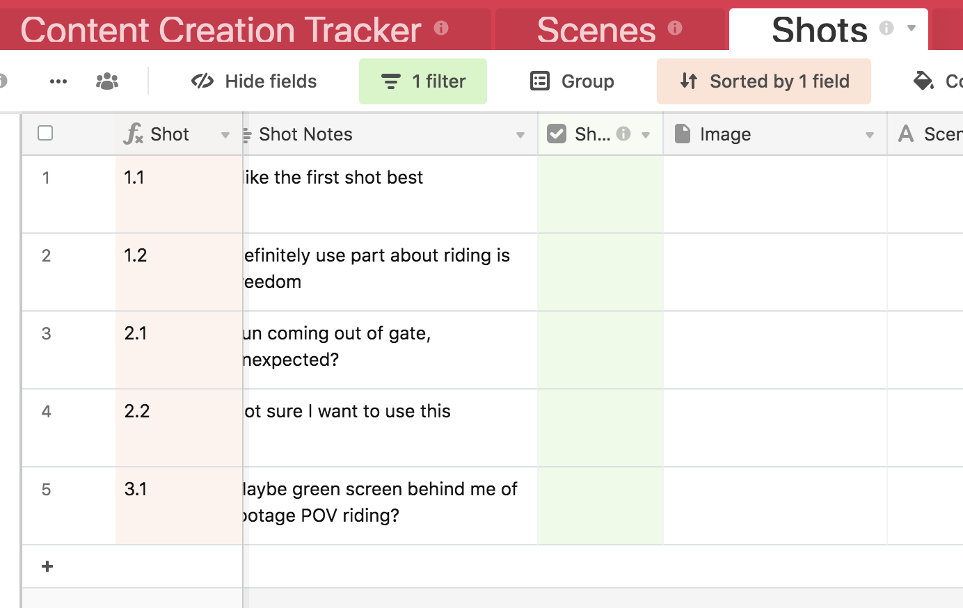

In the Shots Table each record is based on the Shot Number. I have a checkbox field (Shot?) that I check when that shot has been filmed.
Filmed scenes get sent to an Archive View when that checkbox field is checked.

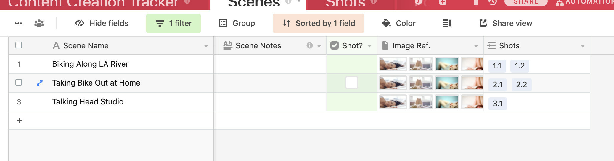

What I’d like is an automation that checks my (Shot?) field in the Scenes Table when all shots for that scene have been checked in the Shots Table and entered the Archive view.
For example, in the screenshot below when the shots listed in the (Shots) field enter the Archive view in the Shots Table the (Shot?) checkbox gets checked.

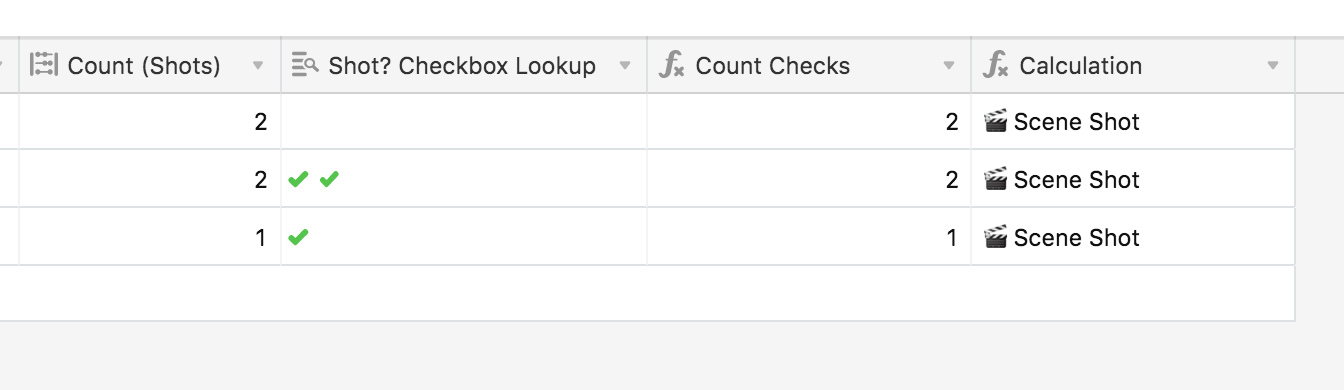

I guess I haven’t figured out step number 3.
This is the formula I used.
COUNTA({Shot? Checkbox Lookup})
It’s showing the number of total shots instead of the checkboxes.
Ignore this part I figured it out.
Putting this here in case it’s helpful to anyone else.
I needed to have it meet certain conditions
Where Shot? is [checked]
Okay. I’ve got it working.
This is the formula I used:
IF({Count (Shots)}={Count Checks},“ :clapper: Scene Shot”, “ :movie_camera: To Shoot”)
I did not incorporate the check to make sure both are greater than 0 because I didn’t know how to.
I’m sure there’s a good reason for this part of the formula, I just can’t wrap my head around why and probably won’t until I come up on a situation where I go “oh that’s why”. lol
Anyway please suggest how to incorporate that into the formula if someone knows how.
Then I’ll mark as solved. :slightly_smiling_face:
Thank you @ScottWorld.

The reason I wanted you to check if both fields are greater than 0 is because if you create a brand new scene from scratch, both “count of shots” & “shot checkbox lookup” will start off as 0, so it will say “ :clapper: Scene Shot” before you’ve even typed in anything about that scene.
So here’s how you could setup that formula:
AND(
{Count (Shots)}>0,
{Count Checks}>0
" :clapper: Scene Shot", " :movie_camera: To Shoot")

Aah! Of course @ScottWorld . And I would have come up against that problem quickly and sat there forever trying to figure out what was happening.
:pray:t4:
