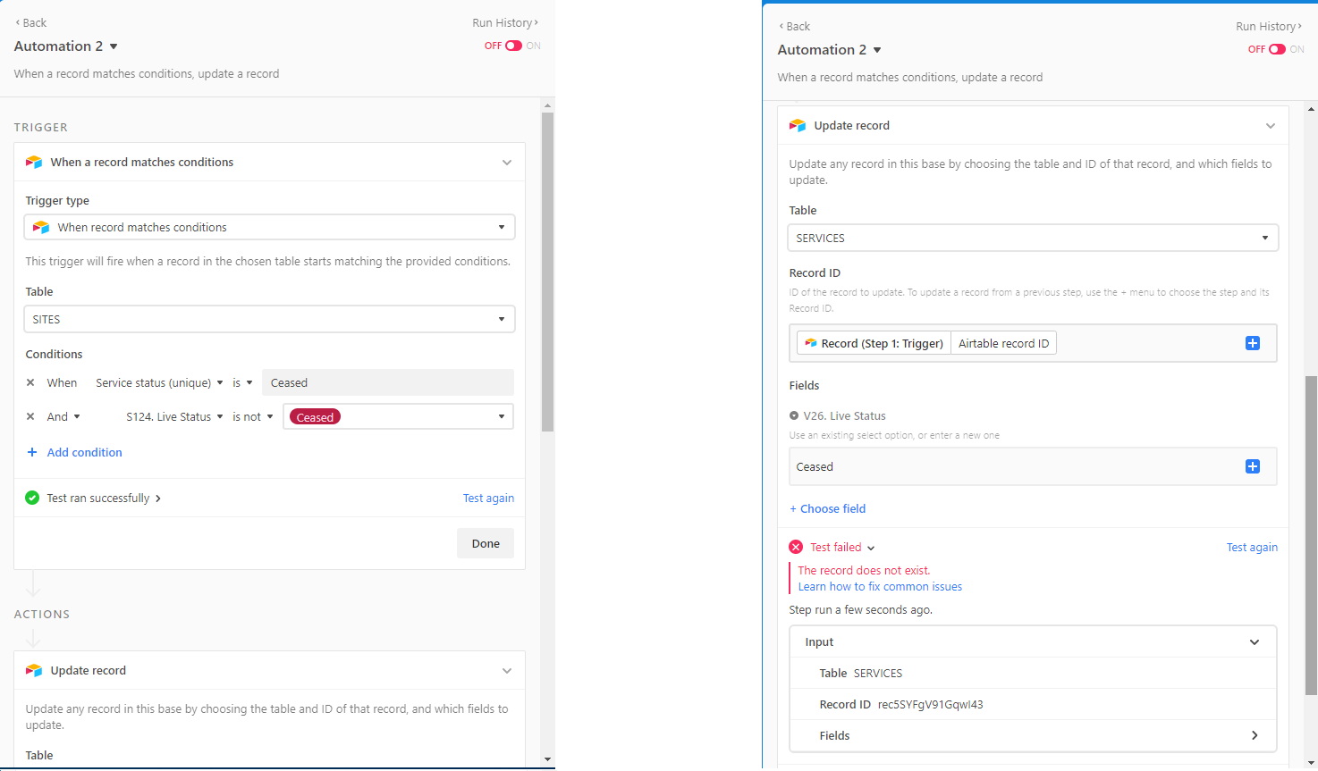

The second step of the automation is showing as “Test failed” - Record does not exist. See attached screenshot.
My bad, change the table to [Sites]. (the record doesn’t exist because the record ID is coming from the Sites table but is trying to update some record in Service.)
