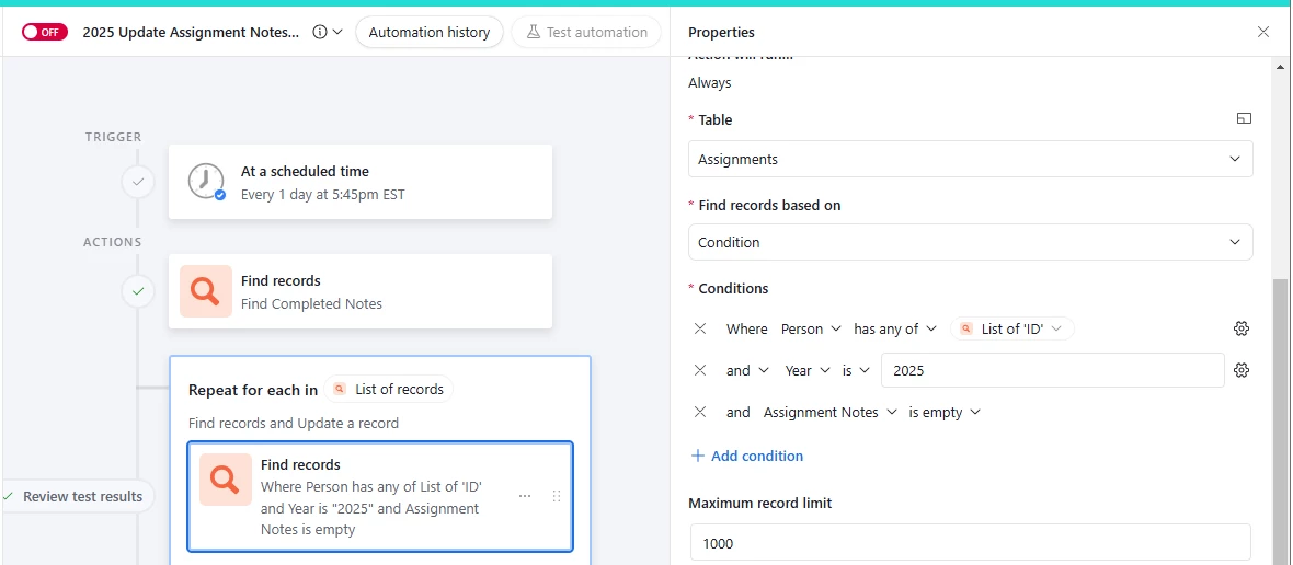

Here is Step 2, it yields the results I expect.

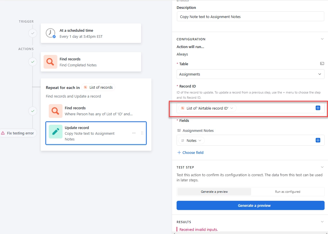

Here is Step 3 where I get the "Invalid input" error message. How do I select the RecordID of the row we're iterating through in the Assignments table?

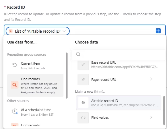

I'm not sure what to select here:

To achieve step 1 above, you'll first want to change your trigger for the automation to run "When a record matches conditions" rather than on a scheduled basis. Such conditions should be when a record in the Notes table gets marked as complete.
Also, in order to achieve steps 2 and 3 it would not be enough to have the Assignment linked to the person, but you should have it linked to the Notes. In such way you could set a condition on you find assignment block where Notes field in Assignments table is exactly record record id from the record that triggered the automation.
Given that multiple assignments could be linked to the same Note, you should also now have a Repeating group which will use as input the list of record ids found by the Find Record block.

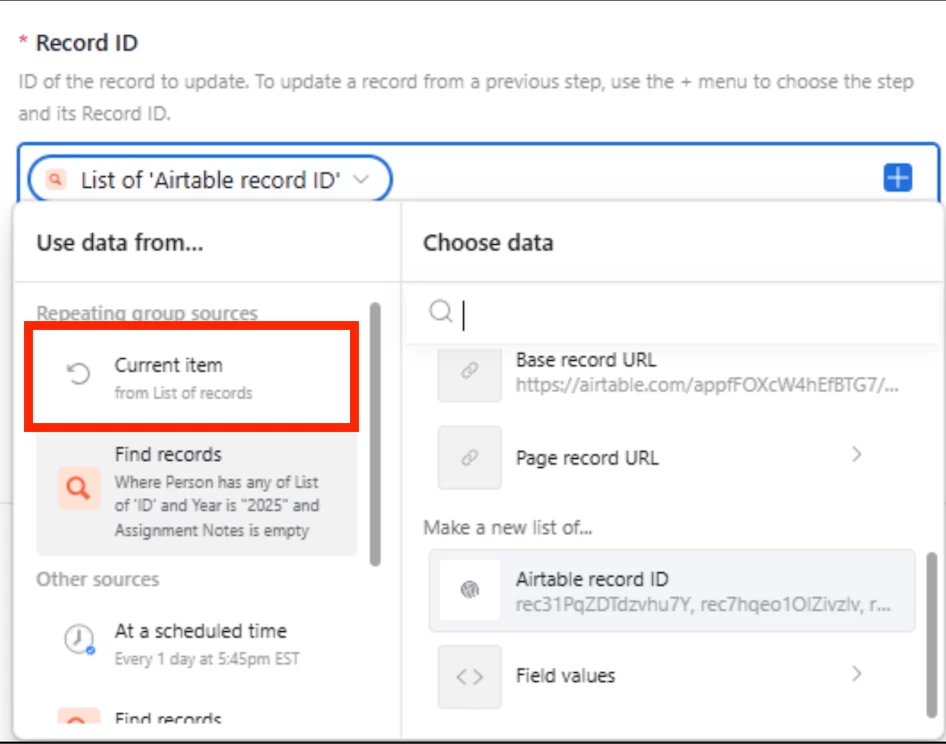

For last, you'll have an update record action block which will use the record ID of the Current Item (and not of the Find Records block as you are showing on your image).
The reason why you a receiving such error is because you are providing an array (list) to the recordid field of the Update Record action block as many records were found on your Find Records action block. If you take a close look to the screenshot below that is what I mean by selecting record id from Current Item and not from find records.
Please let me know if this works for you, or if it makes kind of sense 🙂
