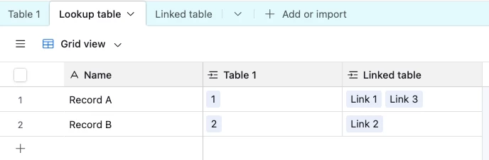

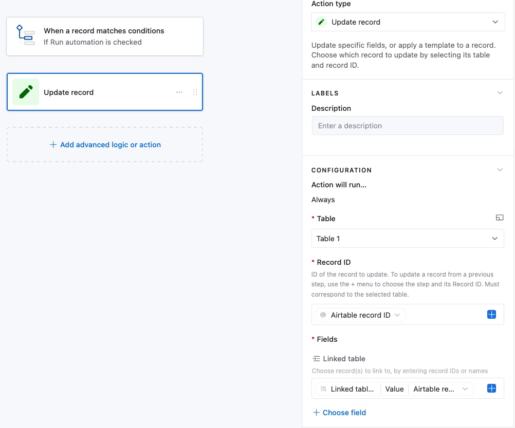

Does this look right?  If so I’ve set it up here for you to check out!
Here’s how the Lookup table’s data is structured and the automation setup:

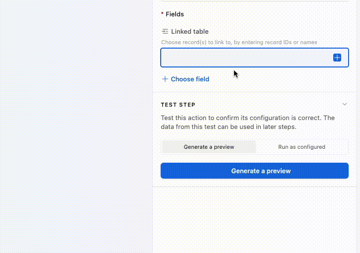

The tricky bit is setting the value for the Linked table field and here’s a gif of how to do that:
