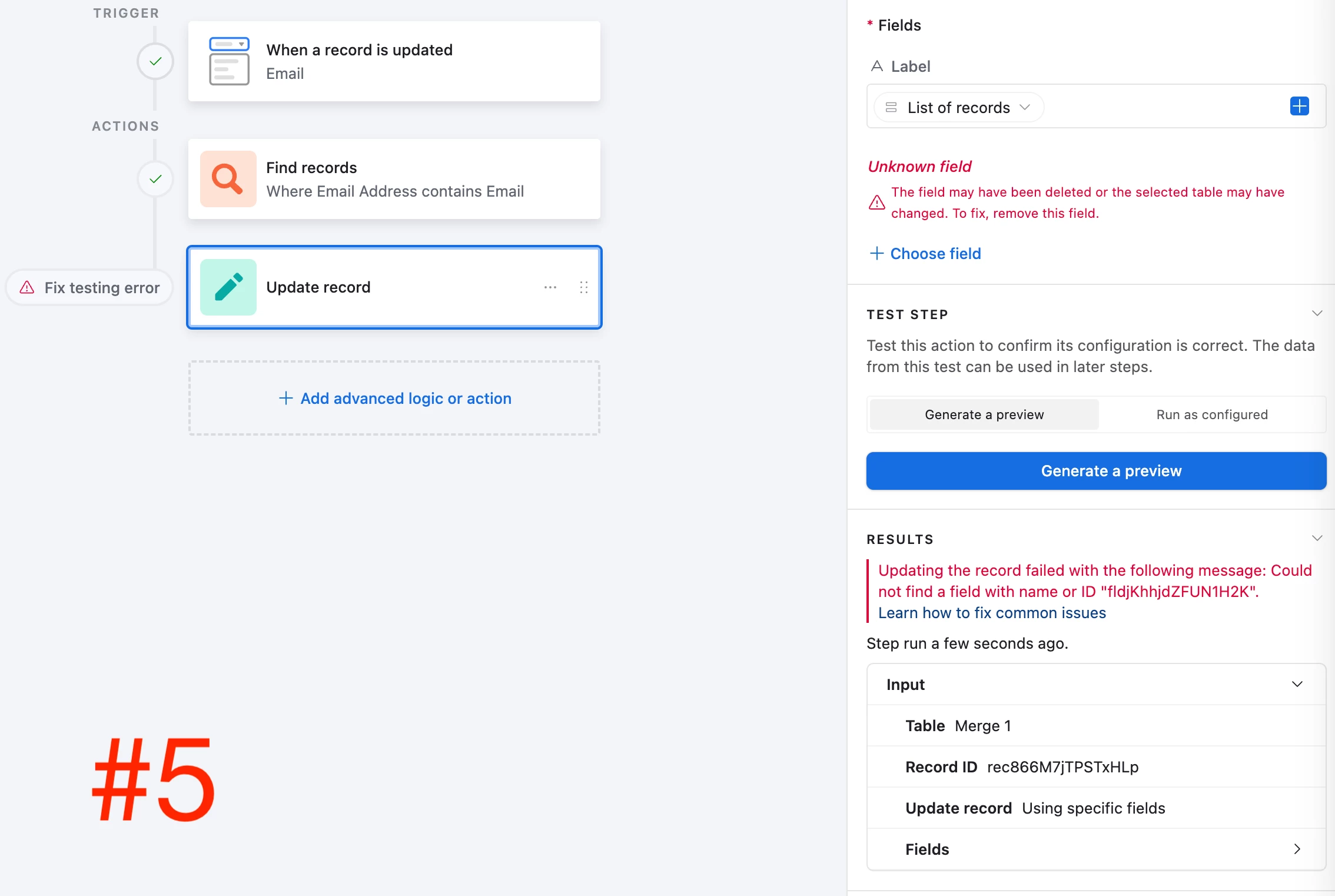

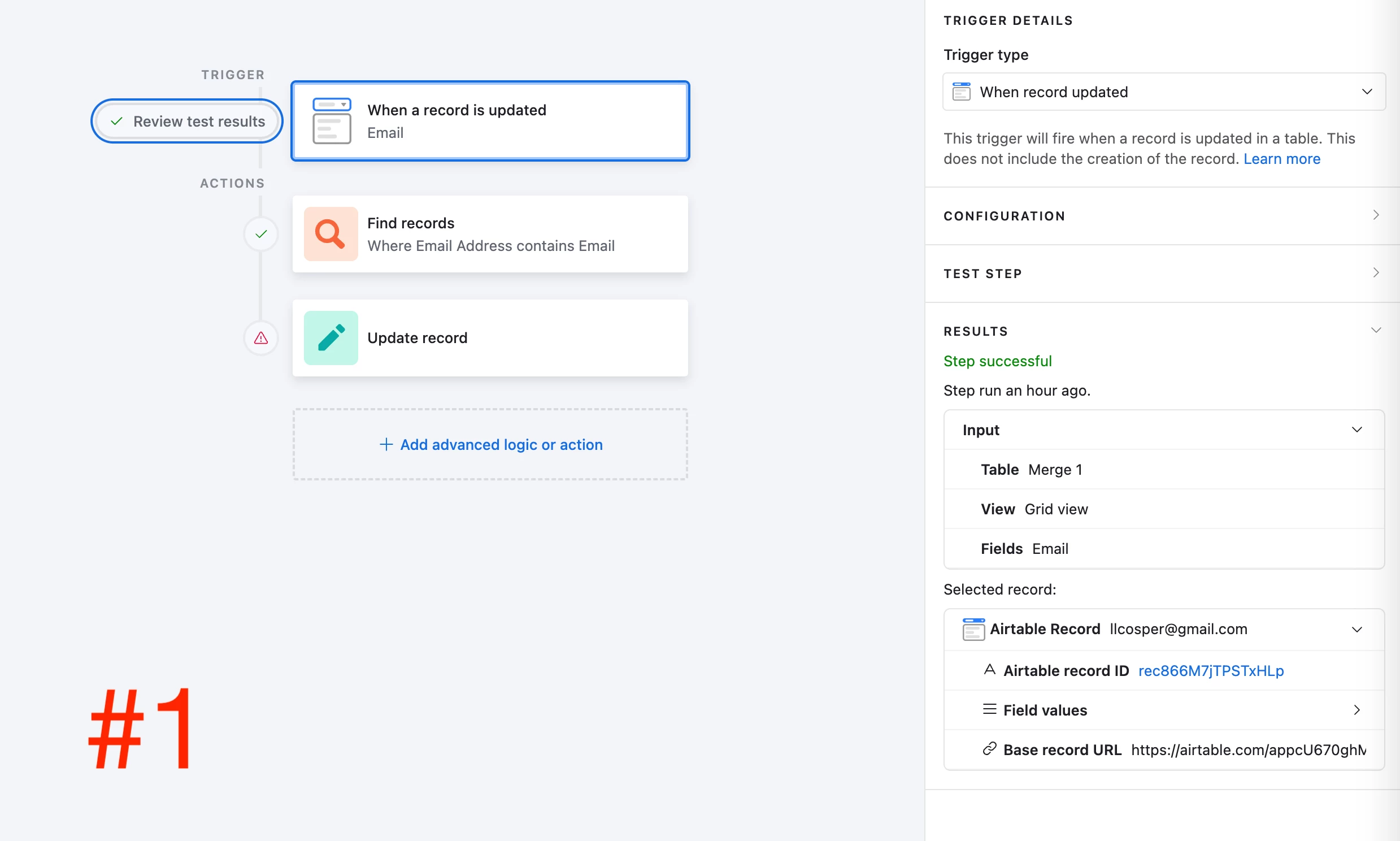

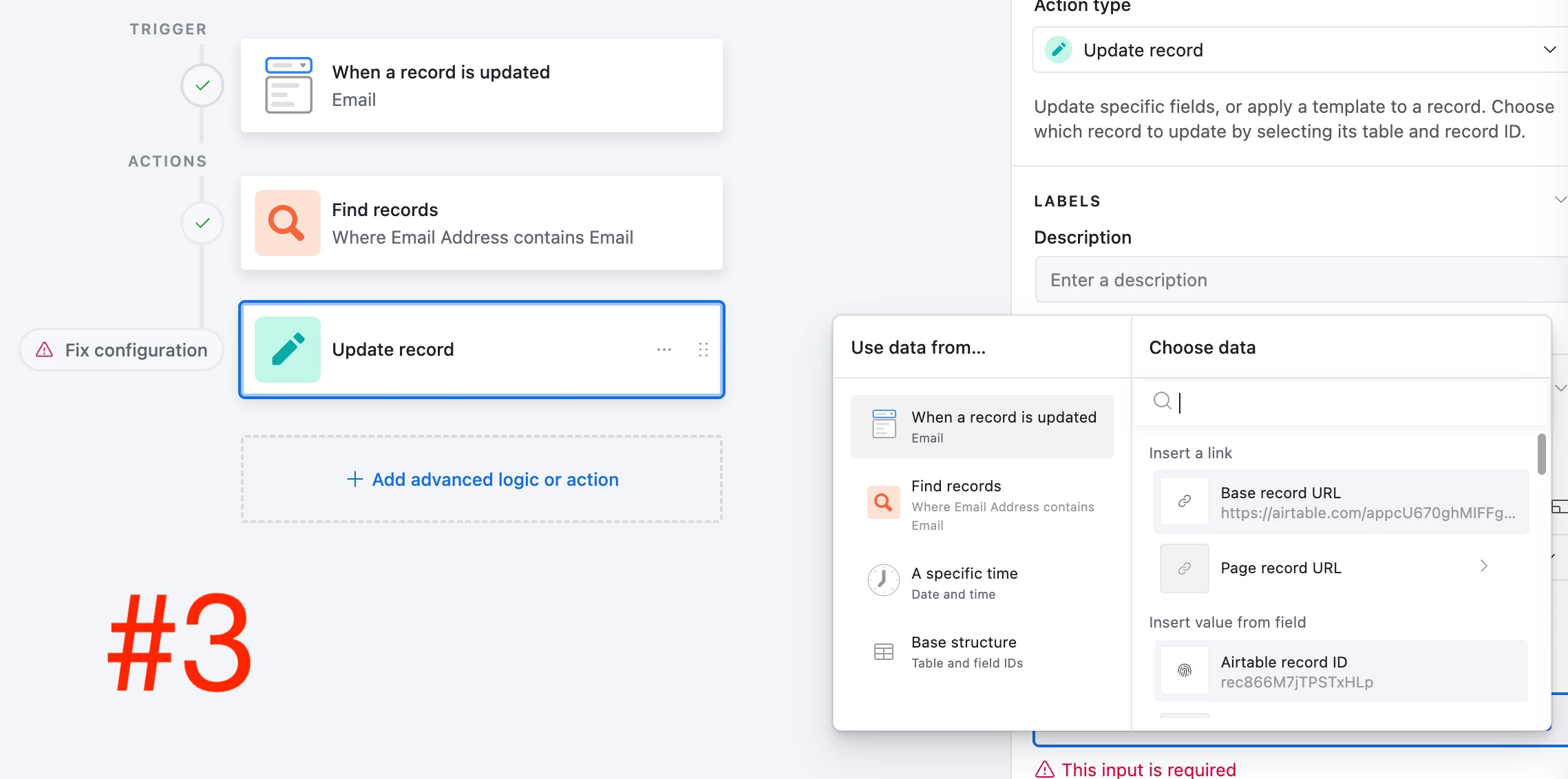

I'm having trouble getting past the Update record in an automation:
I was able to:

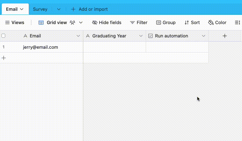

- get the trigger to catch a new email in a table (pic #1)

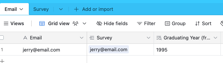

- filter out the matching email and corresponding row (pic #2)

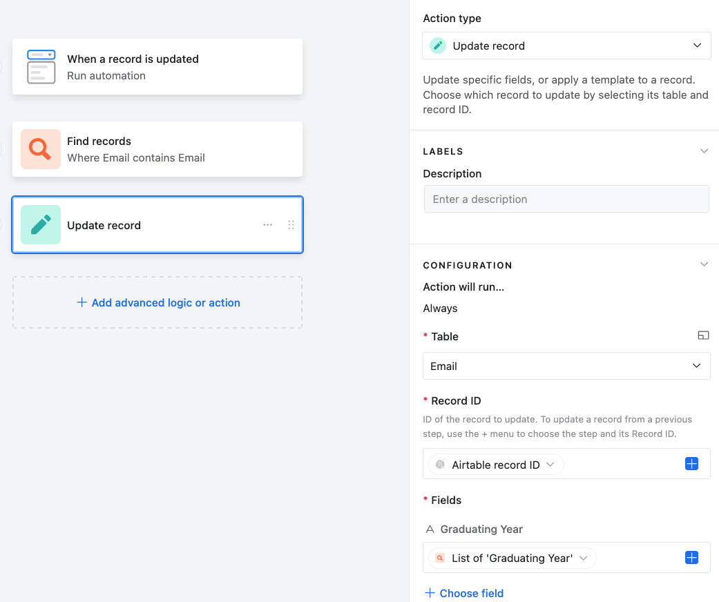

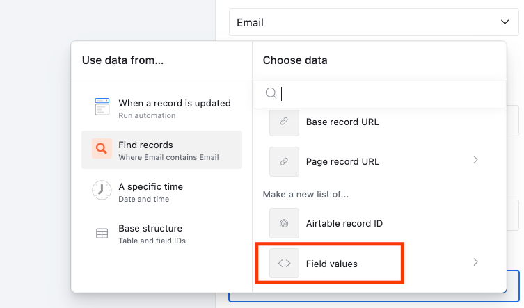

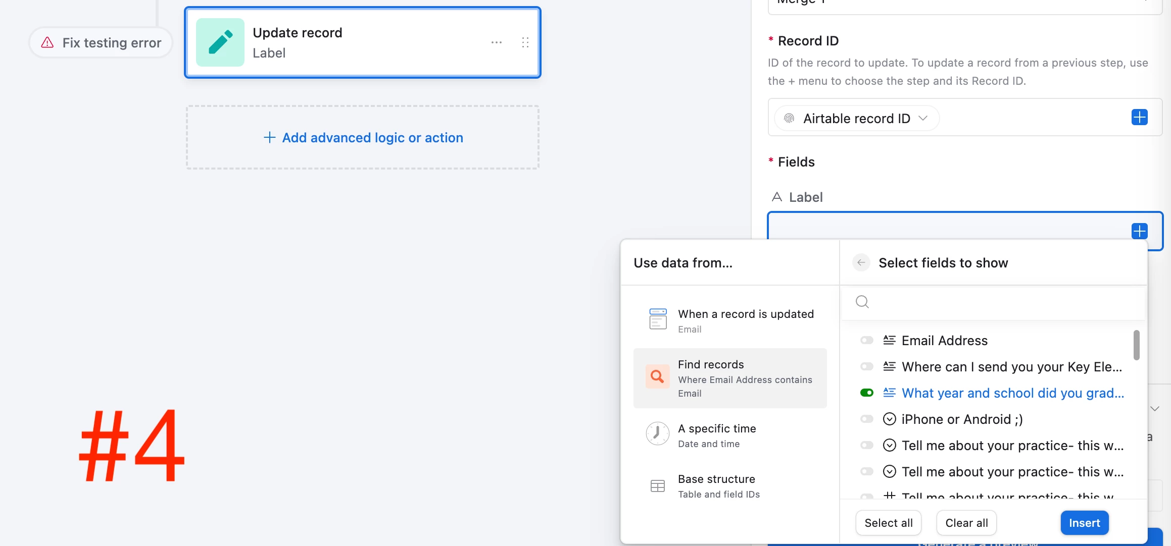

In the Update action, I used the Airtable record ID from the first step (pic #3). The field of interest I want to import from the donor table, for example, is What year and school did you graduate from (pic #4) but it doesn't work (pic #5) and I also dont see where in the receiving table I can choose where the donor information I want to collect to insert.

So right after posting this, I saw @ScottWorld 's reply to my other post and tried to fix the above within Make using Watch Records > Search Records > Upsert a Record and I go it to work! So exciting! But still curious why I couldn't get it to work within Airtable. Any and all advice would be greatly appreciated 😉
Hmm, that error message seems to indicate a field you were trying to update has been deleted.  When trying to insert data into a field, we also need to use the field values, not the 'Insert as list' bit:
Here's how the automation should look:
And here's it working:
And I've set it up for you here
