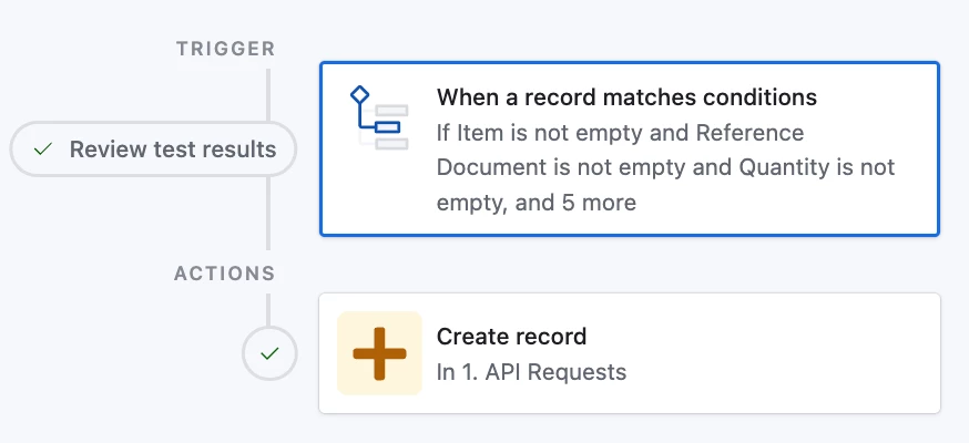

I would appreciate it if I could get some help on this. So the context is that I have two tables. 1 table is for quotation (Tbl_RFQ) and another table is for when quotation is confirmed (Tbl_Confirmed).
For example, an item in Tbl_RFQ may invite 3 bids (i.e., 3 records). However, only 1 bid will be selected for each item. When the winning bid is selected, new record will be created in Tbl_Confirmed.
This requires an automation which I managed to do.
Automation to create records in anther table

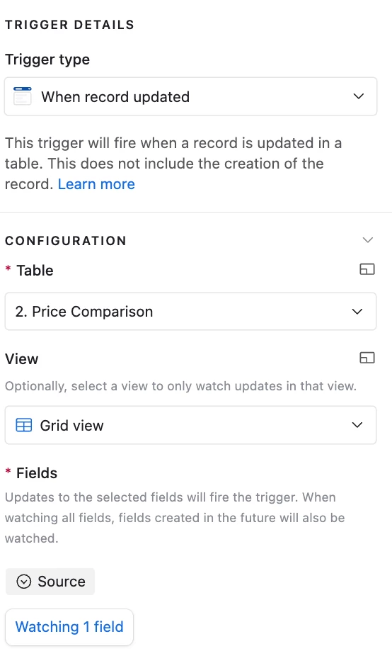

Automation to update status on created records in another table
Automation to update status on created records in another table (2)

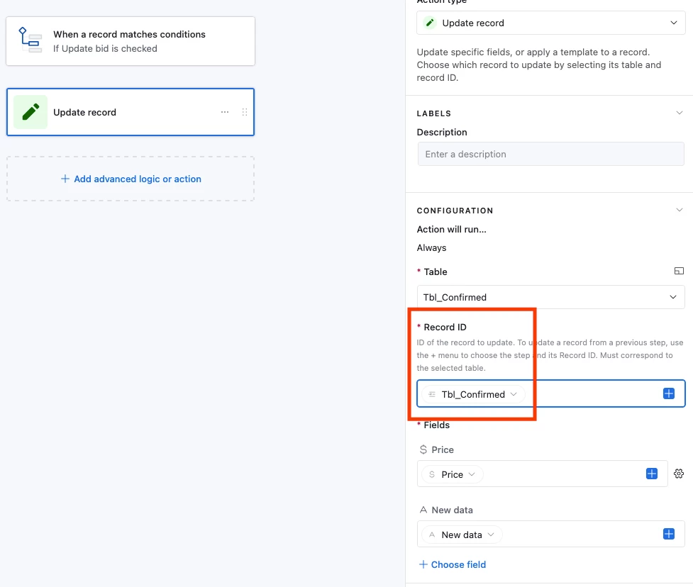

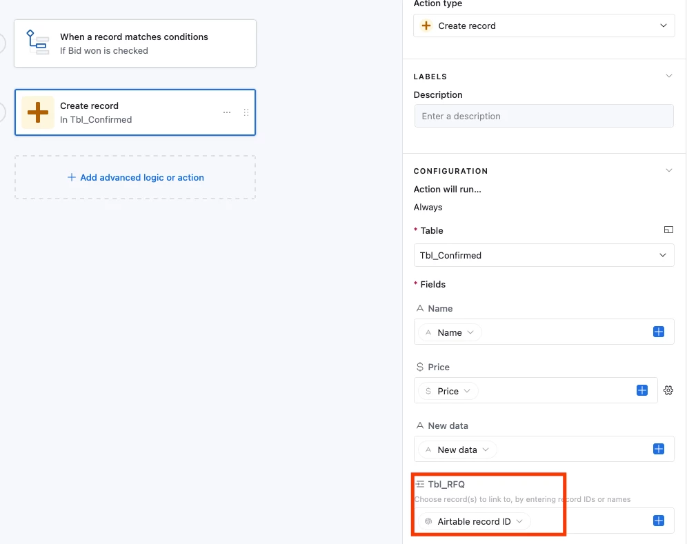

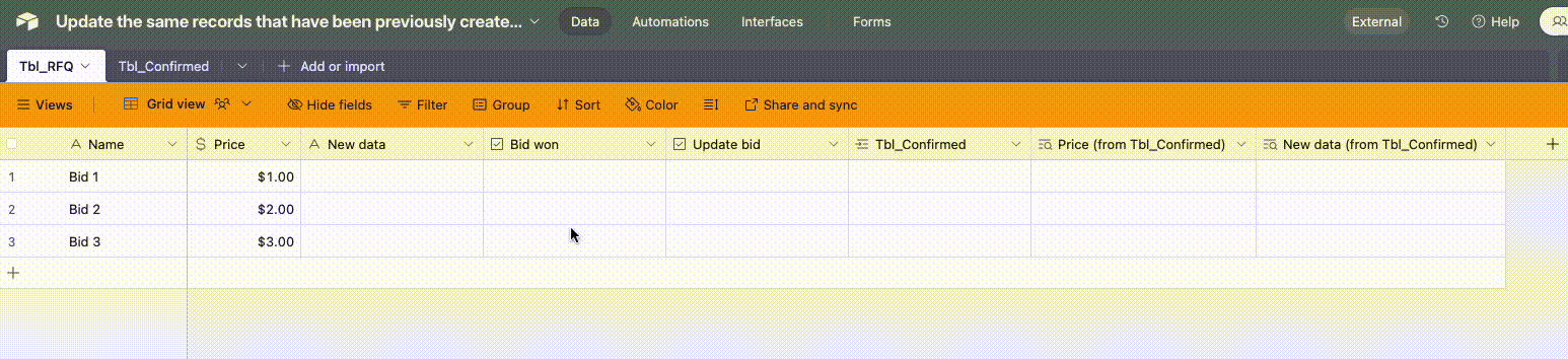

How does this look?  I’ve set it up here for you to check out
The idea is to link the bid to that new record that gets created on confirmation:
That would allow you to use that linked record ID for the automation like so:
I assume you need to be able to manually update the fields in Tbl_Confirmed, and that’s why you can’t use lookup fields to just display the data instead?
I’m also kind of curious as to your workflow, does Tbl_Confirmed have a ton of processes / fields that aren’t relevant to the bidding process, and that’s why you separated it into two tables?

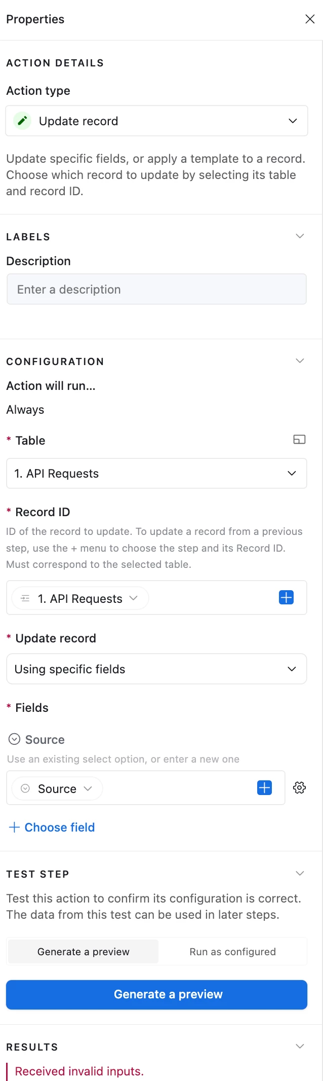

 Good day Adam,

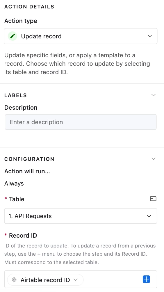

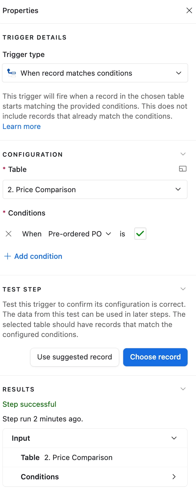

I am not entirely sure why. I followed your step in linking the two tables together. However, the error says received invalid input. The first “When record matches condition” works. However, the second type does not work. It appears that the record ID is “linked” somehow.

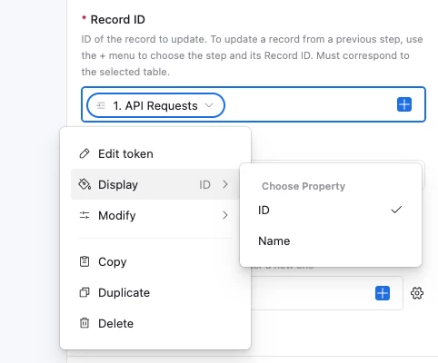

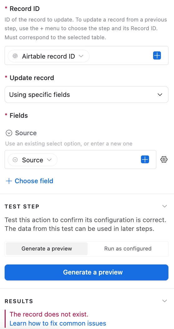

I have also tried this other variation, but it also does not seem to work.
Hmm, could you provide some screenshots of your tables?  Would love to help but need more info I’m afraid.  If you could DM me a link to your base that’d be great
Try updating the automation to use the Record ID instead!
