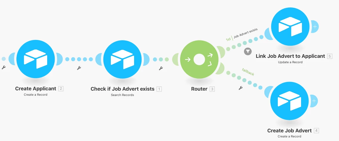

Hmm, you should be able to do this all within a Make scenario like so:
This will either create a new Job Advert if it's the first person who's applying for that job, or link the new Applicant record to the existing Job Advert record.  What issues did you face setting this up?

Yeah this will lead to lots of uneccesary operations being used after the job ad has been created unfortunately.
I actually solved this by creating a new scenario with a webhook that will trigger from airtable when a record is created that gets the office from the first candidate and adds that to the job ad record. I am sure there is probably an easier way to do this but it works for the moment so cant complain.
