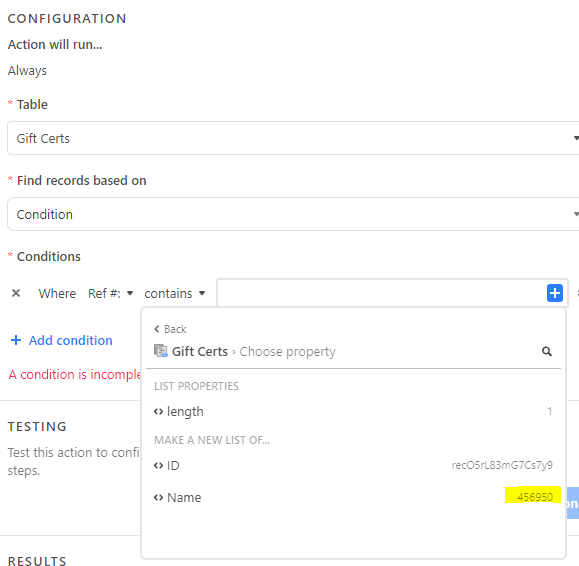

I have a table, with has reservations for a small hotel, I have another table with Gift Certificate reference numbers. When a gift certificate reference number is used, I’d like it to search through the records in the Gift Cert. table and change the status to redeemed.
Basically, I want to link these two tables, but I’m not sure how to go about it. I think it’s a junction table … i think I know what a junction table is … in theory, but I’m not sure how to make it.

That would make sense, but my reservations are fed through another system into Airtable. So I was hoping to make an automation that did the work for me. I get so confused, I start out making this awesome automation, but I get distracted by all the possibilities and options, and then I forgot what I was doing.

Is your setup incompatible with Link fields? If it is compatible then you don’t need an automation at all, just convert the field and make a formula as described above. If it is incompatible with Link fields just have the automation trigger when {Original field your system is filling in} is not empty and does not match the {Link field} and use a Update Record step to fill in the Link field with the value of the Original field.

Yes - this is what I’m trying to do. But I think I’m more than a little confused … so I was trying to just enter the # of the gift certificate, so I drilled down into the dynamic variables… but it wouldn’t let me ‘INSERT’.

That is not an Update Record step its a Find Records step. The process I recommended does not involve finding records, what are you finding records for?
