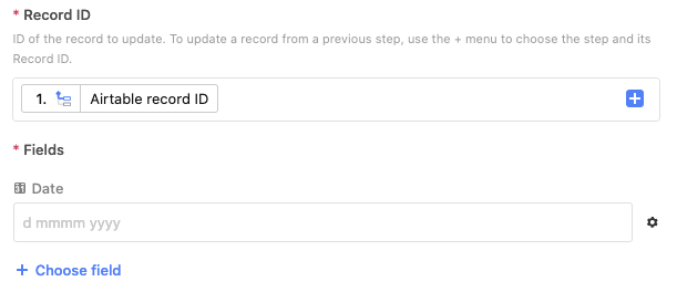

Hm, I just left the field empty and it seemed to work
Working version here
Hmm, this would be possible via an automation that triggered when the status of a record was “To Do”, and then the action would be to update the “Start Date” and “Completed” fields to be blank?
I feel like I’m missing something though, apologies

Yeah, I have set up an automation to detect the “To Do” status and I tried making a static date that wasn’t filled in, but that didn’t update the record unfortunately.
  • May 12, 2022
That worked! I just had to reselect the To Do Status.
Thank you!
