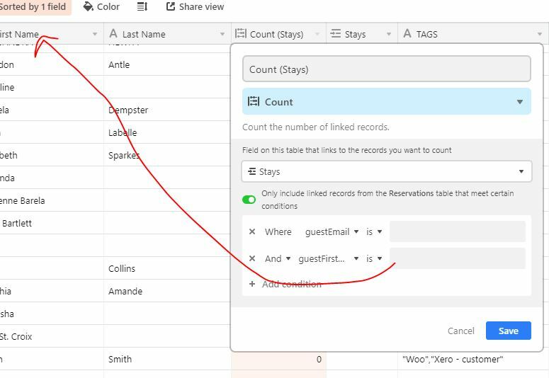

I have a small hotel, and I wanted to calculate the number of stays each guest had with us.
Is it possible that I can create a record like this and have the guest email and name as a variable for each column (see attached photo)?
I can’t change the {guestEmail}, cause it’s coming from the API … and it won’t populate automaticlly if I change it
In that case you’d leave {guestEmail} alone and set up an Automation to copy the value from {guestEmail} into your existing Link To Another Record-type field which I believe would be {Contacts}.
This will link all future Reservations records for you. For the existing ones, you could simply copy the entire {guestEmail} column and paste it into the {Contacts}.

Based on your screenshot, it looks like we’re seeing a table for [Guests], where each Guest is linked to one/multiple records in a [Stays] table. You are editing a Count-type field, which automatically only gives you the number of [Stays] records that are linked to each Guest.
Unless your {Stays} column is literally empty, it should already be counting the number of stays per guest.
If your {Stays} column is empty, it means you haven’t actually linked any Guests to Stays, meaning your {Count} field isn’t going to work.

Yeah … stays is empty. How do I link Guests to Stays?
When you click into the {Stays} column there’s a plus symbol, click it and pick the appropriate [Stays] record. Or do the same thing from the [Stays] table.
Records in Airtable do not automatically link themselves together. You have to indicate which Guest should be attached to a Stay.
You likely have been entering people’s names in a regular text field in the [Stays] table instead of filling out the Link to Another Record field.

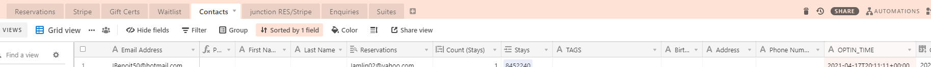

In your [Reservations] table you have a Long text-type field for {guestEmail}, and the primary field in your [Contacts] table is their email address. So right-click {guestEmail}, chose Customize field type, then choose Link to Another Record.
Adjust your {Count} field to pull from that^ field and not your blank one. Then go ahead and delete your blank {Stays} column, and from now on, actually link your records together by filling in {guestEmail}.

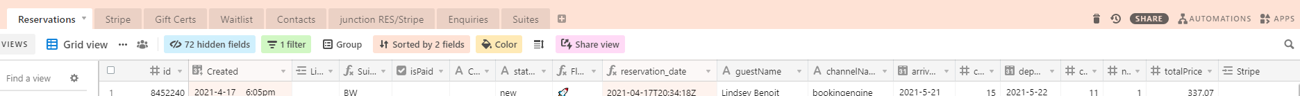

I understand thanks.
This is the contacts Table
This is the reservations Table
there are a lot of columns … would you like me to try to get them all?
Forum|alt.badge.img+10
OMG!!! It worked! You are a God!
Steps:
  1. Create new column (forumla: guestEmail) which just copies that column in to this one
  2. I hid the first guestEmail (cause I know I’ll forget about the automation with the API one day, and edit it
  3. I already had a column that linked to the guest email in the contacts table, so I just copied the entire column and pasted it into the new column
Thanks for your help.
