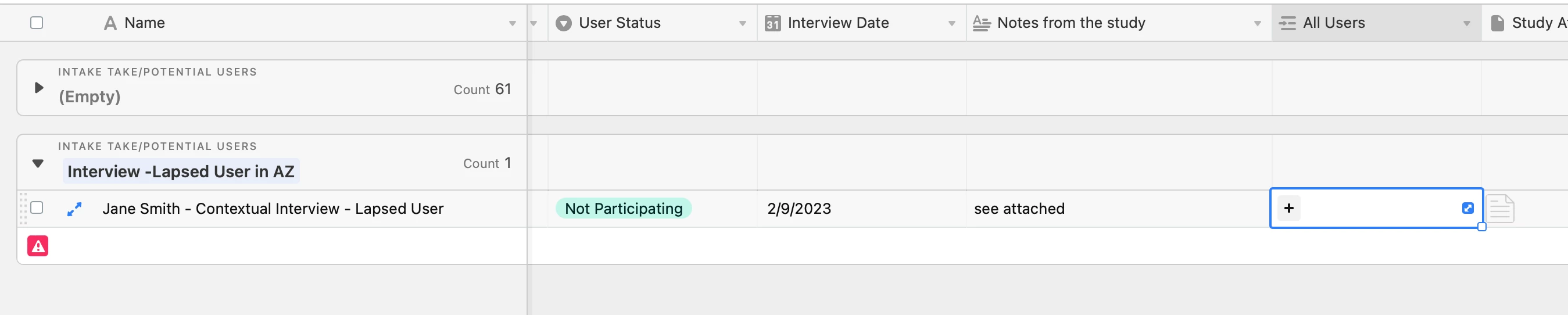

Table 2: UXR Notes by Study/User
  • Primary field: user name - study type - study description
  • User name:
  • Study type
  • study description
  • User status: contacted, not participating, participating
  • Interview date
  • Notes
  • User: look up from table 3, link from "potential users" on table 1
  • Goals
  • Hypothesis
  • Attachments
  • Study Guide
  • Study owner

> 2. How can I link the table 3 to table 2 so that whatever study a user is involved in, the record on table 2 shows up to the corresponding user record on table 3?
Given that Table 3 and Table 2 are in different bases you're never going to have a "real" link I'm afraid.
The simplest way to do this to me would be with synced views.  You'd sync Table 2 to the base with Table 3 in it, and create an automation that would appropriately link the synced view records of Table 2 to their respective records in Table 3
This requires at least a Plus plan for automatic syncs, and would be 5-15 minutes behind
The next option would be some third party service like Zapier, where, on the appropriate update of a record in Table 2, you look for the record in Table 3 and update it
And lastly, there's always scripting
