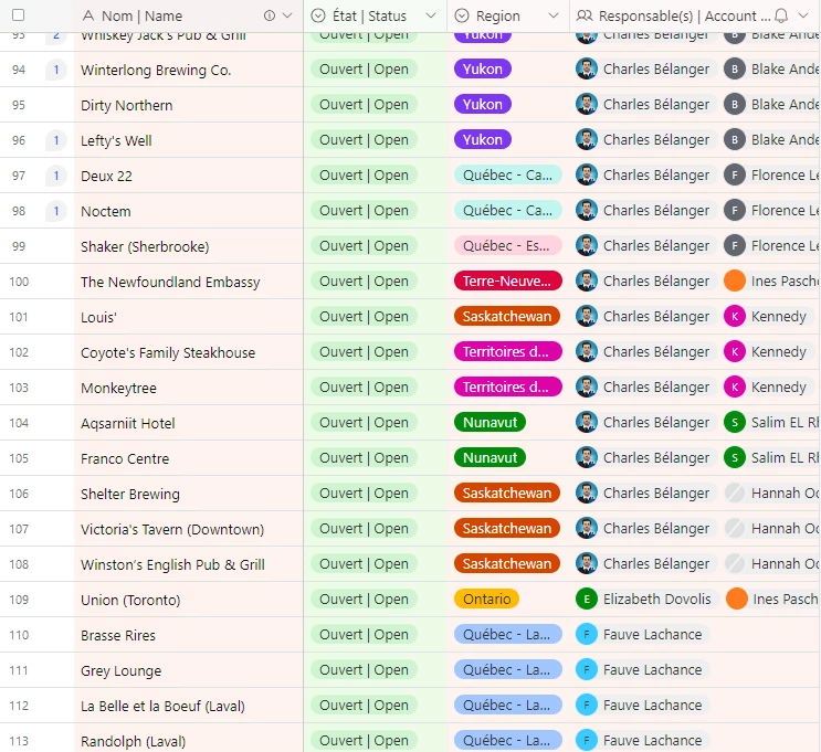

Hi everyone ! 🙂
I'm running into an automation puzzle and would love to have a little help.
Take a look at the picture attached. I have a list of clients (column A) and each of these clients are linked to their account manager(s) (column D). Other columns are various infos about each client (status or region - columns B and C - I've kept these as examples).
I want to send a weekly reminder, by email, to each account manager, with all the clients they have to reach out to this week (according to a filter on which the view is based - Priority Status (not shown)). Things would then go like this :
  • Charles receives an email with a list of every bar for which they are account manager, so everything from line 93 to line 108
  • Ines receives an email with the 2 bars for which they are account manager, so only lines 100 and 109
  • (and so on, for every account manager)
I'd love to be able to do this without adding a new table to my board (i.e. without a separate table listing all the account managers), and by keeping the "Users" field type I'm actually using. I've seen a similar issue solved here : https://community.airtable.com/t5/automations/emailing-a-weekly-digest-to-separate-users/m-p/156341#M12030. Someone in the comments said a script would be needed? I'm not sure how I would start to set that up...
Any ideas?
Thanks in advance!

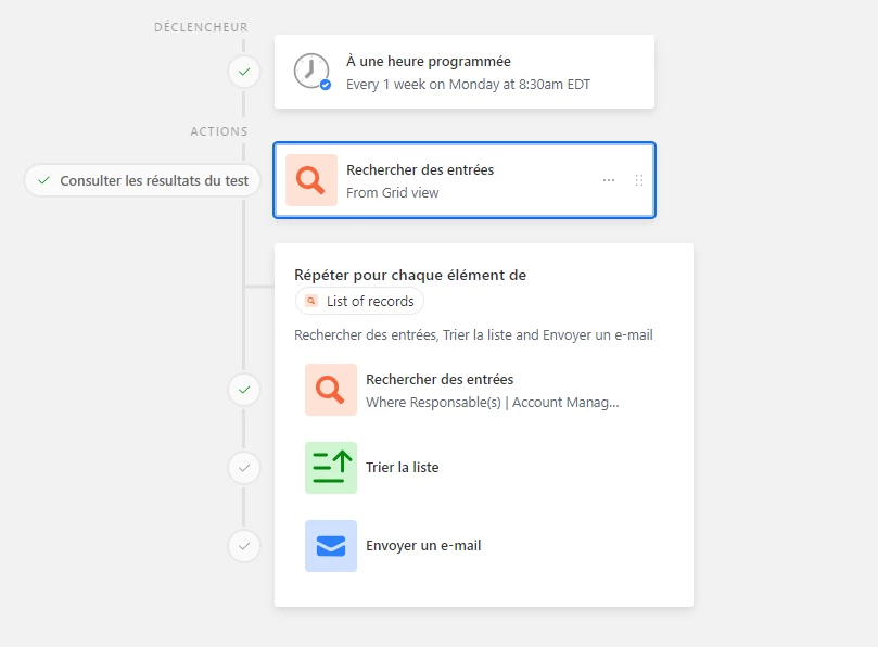

That works quite well actually ! However, it looks like because I use the "Repeat" for every item on the list option, I can't use conditional logic. I would like for the email to be sent ONLY if there is something on the list (so, no email if the list is empty - i.e. if list length = 0).
Any idea of how I could achieve this?
(Automation attached for reference, but it's in French, sorry!)

Thanks for the screenshot!  Ahh...yeah that's a tricky one.  Try:
1. Create a "Tasks" table
2. Make the repeating group action create a record in the "Tasks" table with each User's details
3. Create another automation that'll trigger whenever a new record gets created in the "Tasks" table
  - This automation will be the one that does a "Find Record" action to look for the "Client" records, and you can now use a conditional to only send the email if there's one record found or more
  - Put in a Run a Script step to delete the triggering record (Example here: https://community.airtable.com/t5/development-apis/delete-a-record-by-automation/td-p/112769)
