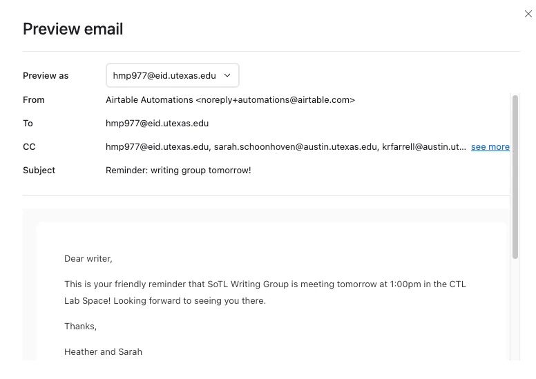

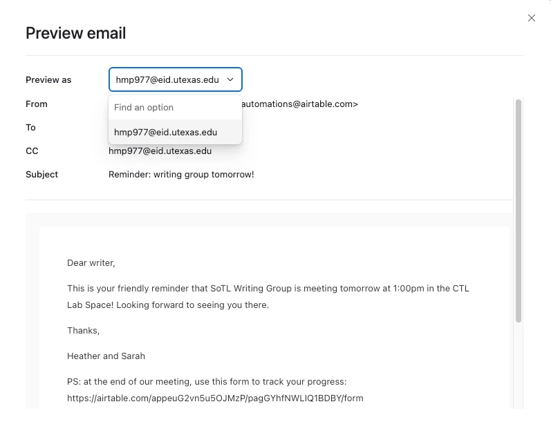

​@BuildForAT, that does seem like it would work better, but all four of us are still automatically being CC’d to the reminders.  (screen shot of preview included in case it’s helpful). When I go to the CC field, nothing is there, so I can’t remove anything.

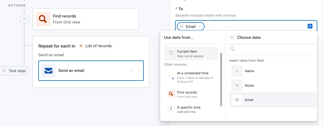

If you want to eliminate the CC list, we’ll do something else instead. We’ll go back to having that repeating group with the send email action.
But now, in the “To” field, we’ll put in “Current Item” and select their email:
This should send a separate email to each member.
Let me know if that gets you what you want.

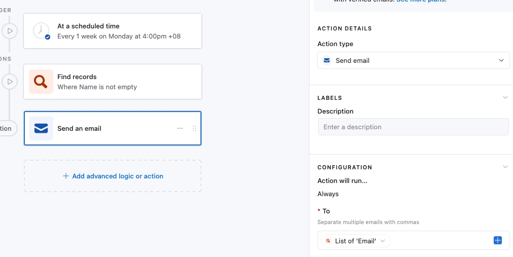

This happens because when you use "Find records" and then send an email to the whole list, Airtable ends up sending multiple emails to each person.
To fix it, use the “Repeat for each record” step, and in the email action, make sure the “To” field pulls the email from the current record, not the full list. Each member row should have just one email linked to it, so this way each person only gets one email.
Double-check that CC and BCC are empty too, just in case.

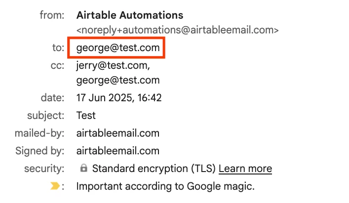

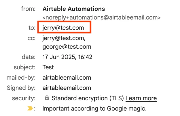

re: all four of us are still automatically being CC’d to the reminders.  (screen shot of preview included in case it’s helpful). When I go to the CC field, nothing is there, so I can’t remove anything.
Ah this is expected actually.  Assuming you have 2 addresses in the ‘To’ input, e.g. jerry@test.com and george@test.com
Then when Jerry opens their email, this is what they’d see
And this what George would see:
Assuming your automation’s set up like this, then that’s going to be sending out one email to every email you’ve found and you won’t need to worry about the CC field:
If you don’t want them to be able to see who else is getting the emails, then BuildForAT’s solution will get you sorted

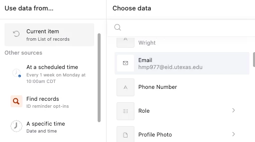

​@BuildForAT and ​@Taha-Jiruwala thanks for your help! This seemed like it would work, but a new problem has come up: it now is only identifying the top person on the list (which currently has four names/emails). So it isn’t CCing anyone, but it isn’t recognizing anyone else on the list, either.
This is what my “To” field token looks like:
And then this is what options I have in the generated preview:
Thoughts? I feel like there’s something very obvious I’m doing wrong but I can’t for the life of me figure out what.

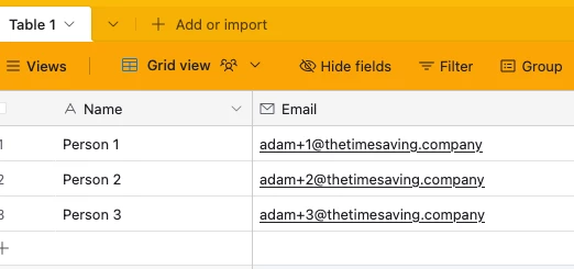

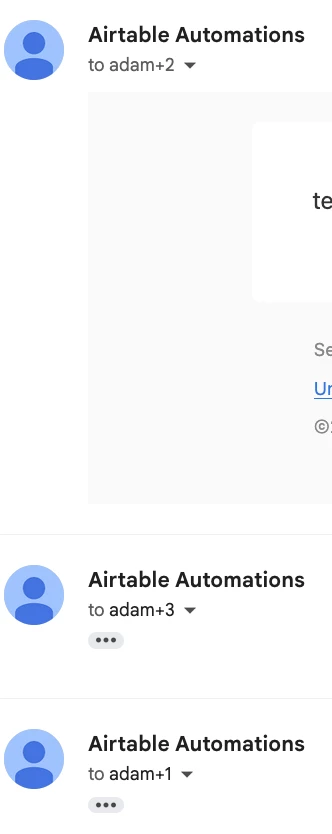

Hmm, yeah, I think I don’t understand something about your setup, hopefully one of the other can help you solve your issue.  As a reference, I’ve set up an automation here that has an automation that:
  1. Has a ‘Find record’ step that looks for every record that has an ‘Email’ value
  2. A repeating group that uses the results of that Find Record step
  3. Sends one email to each person only
Here’s the base data
And here’s what the automation sent out:
Best of luck!

​@BuildForAT and ​@Taha-Jiruwala , thanks again to you both--I forgot to come back and update, but I was able to get the automation to work! I don’t know why BuildForAT’s solution wasn’t working the first time (token being “current item” → “Value from Field” → “Email”), but when I deleted the automation and started over, it worked fine. I know my original setup was wrong, and now I know that this one works...so thanks to y’all for troubleshooting!
