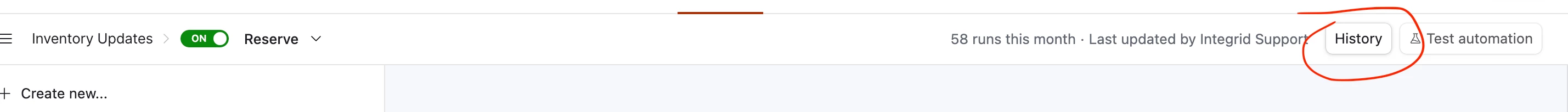

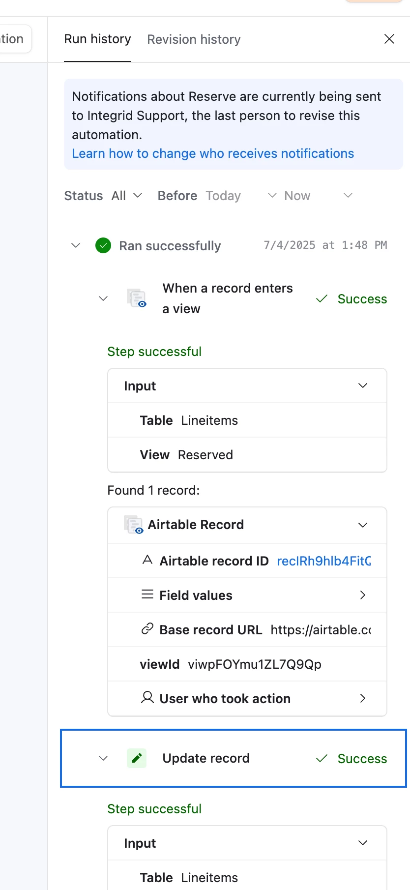

Hey ​@davidjames874,
Would you mind sending screenshots of the automation and of the execution log (history).
That should be enough for us to debug it.
Also, are you using Airtable native Send Email action block, or Gmail, Outlook, or other?
