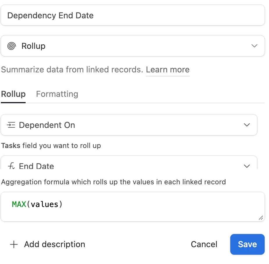

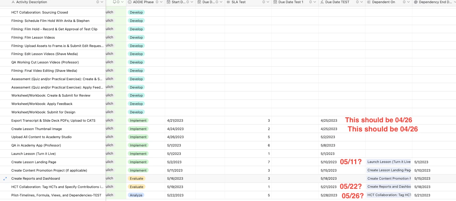

I have a work date formula in the 'end date' column.
IF(AND({Start Date},{SLA (days)}), WORKDAY({Start Date},{SLA (days)}))
When someone changes the SLA number, start dates and end dates changed because I setup a dependency automation.
However, I'm seeing that some of the end dates are on weekends even though there is a work day formula in the end date column.
Any insight?
Also including a screenshot of the dependency roll up.
Thank you!

Hi @JaclynB
Would you mind providing some screenshots of your table, so that I can see the field names/types that you're referencing? It would be helpful to see a few records including where the formula is calculating properly and where it's not. Would you also be able to provide a bit more information on the automation you're using in conjunction with this formula?

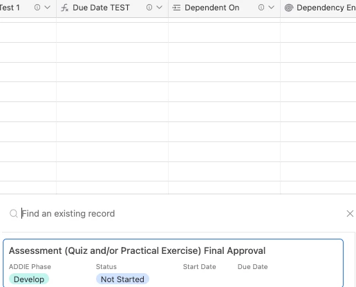

Thank you so much for your help.
I also noticed when trying to add an existing record in the 'Dependent On' field, there are multiple owners who have similar projects (see screenshot). Is there an additional filter or view that will also add the owner's name, so that when selecting the dependent on field, it updates? If I select the project but the owner is not me for example, the dependencies will not update. I only realize iIm not the owner when I've already selected the project and expanded it.

The formula that ended up working best for your inquiry was:
IF(AND({start date},{SLA Test}), DATETIME_FORMAT(WORKDAY({start date},{SLA Test}),'L'),"n/a")
