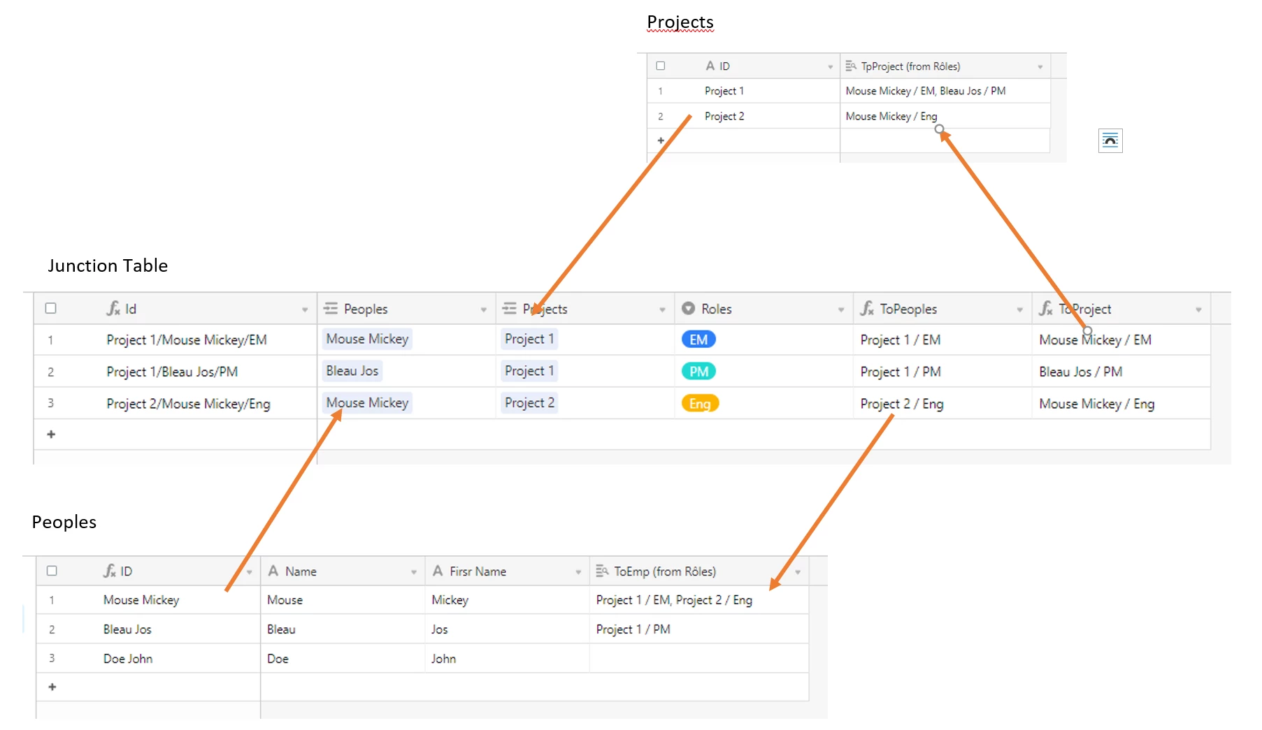

I don't know if this do the job for you,
Add a Junction Table between your tables to define Role, and assigne project and people from that table
Add a formulas ToPeoples (Project / Role), ToProjects (People / Role)
Show these fields in both tables Peoples and Project.
(see attached file)
Let me know

hey, thanks for the reply but not exactly what I was looking for.
I would like to have a person be the record and the column to aggregate all of the projects within the 6 columns on the people table as a way to then plug into an interface down the road. The method you shows now creates a unique id tied to the combination of the person, project, and role.
I think I'll just lose the record link and go with one of the methods I listed above. Still really appreciate the help here.

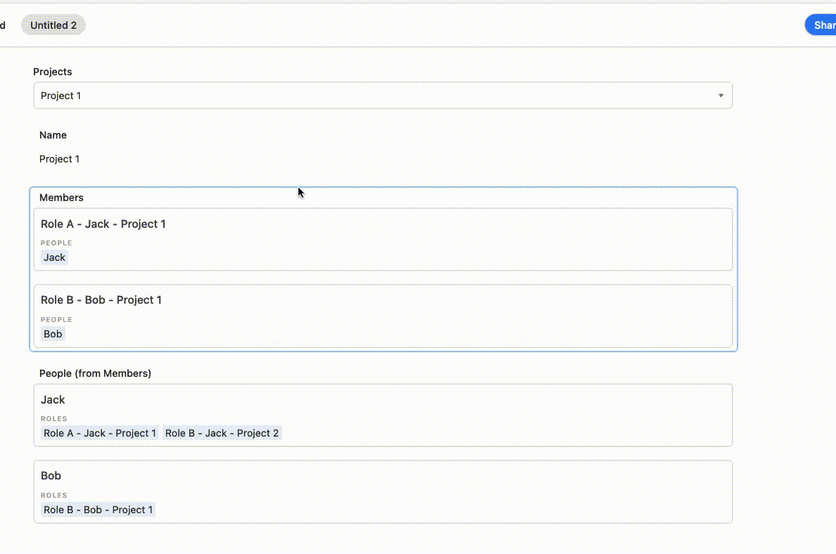

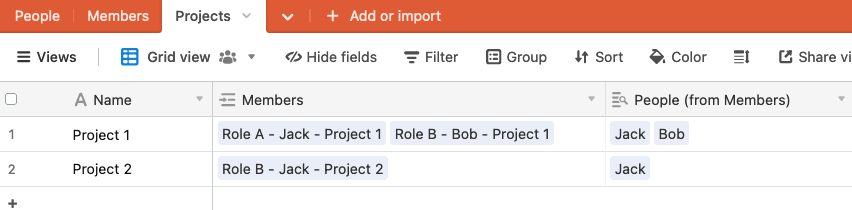

Hmm, if it helps, I'm able to click on a linked record inside a lookup in an Interace of type "Record Summary"?
And here's how the data's set up 
You won't be able to do it via a "Grid" Interface element, but then when I tried to click through to a normal linked record via the "Grid" Interface element I couldn't get that to work either.  (Do let me know if I'm doing something wrong!)
