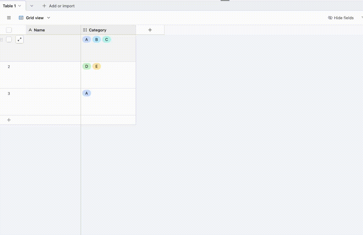

Try converting the ‘Category’ field into a linked field to a new table:
If you need it to be a multiple select, then you could try using an automation to paste the values from the multiple select into a linked field every time the multiple select gets updated
Hey ​@sgabrielli,
As mentioned by Adam, you’ll want to have a new completely new table to such effect. In it you’ll have the list of all possible options -and you’ll link these two tables via linked record field. Just FYI, remember that in Airtable one table can have one or multiple views (more on Airtable views here). So what you want in this case is a table rather than a view!
