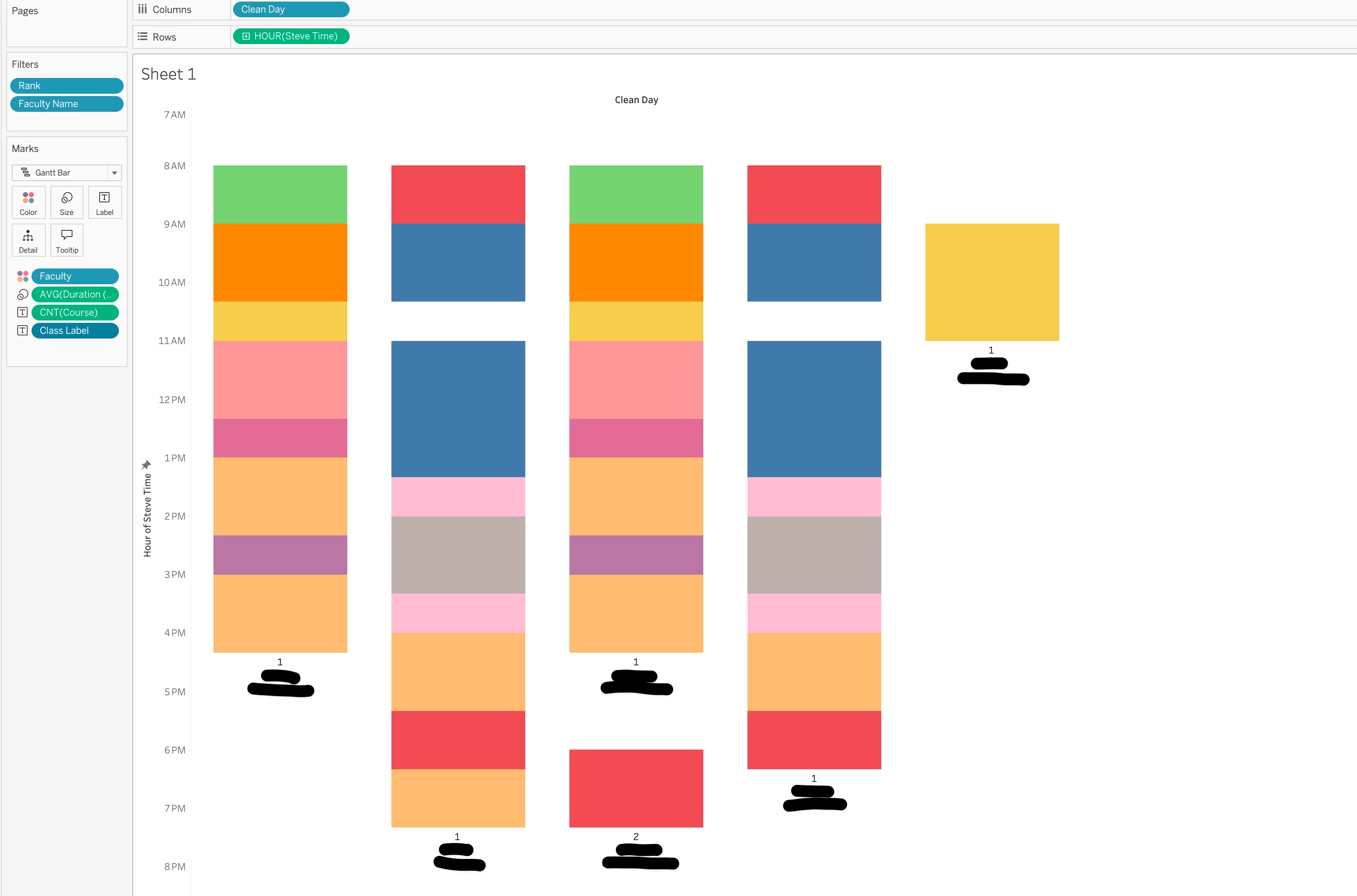

Hm, could you provide a screenshot of your output in Tableau, and a screenshot of your current data?  How the view’s set up sometimes depends pretty heavily on the desired output, and so knowing the output format would be really helpful!
  • July 20, 2025

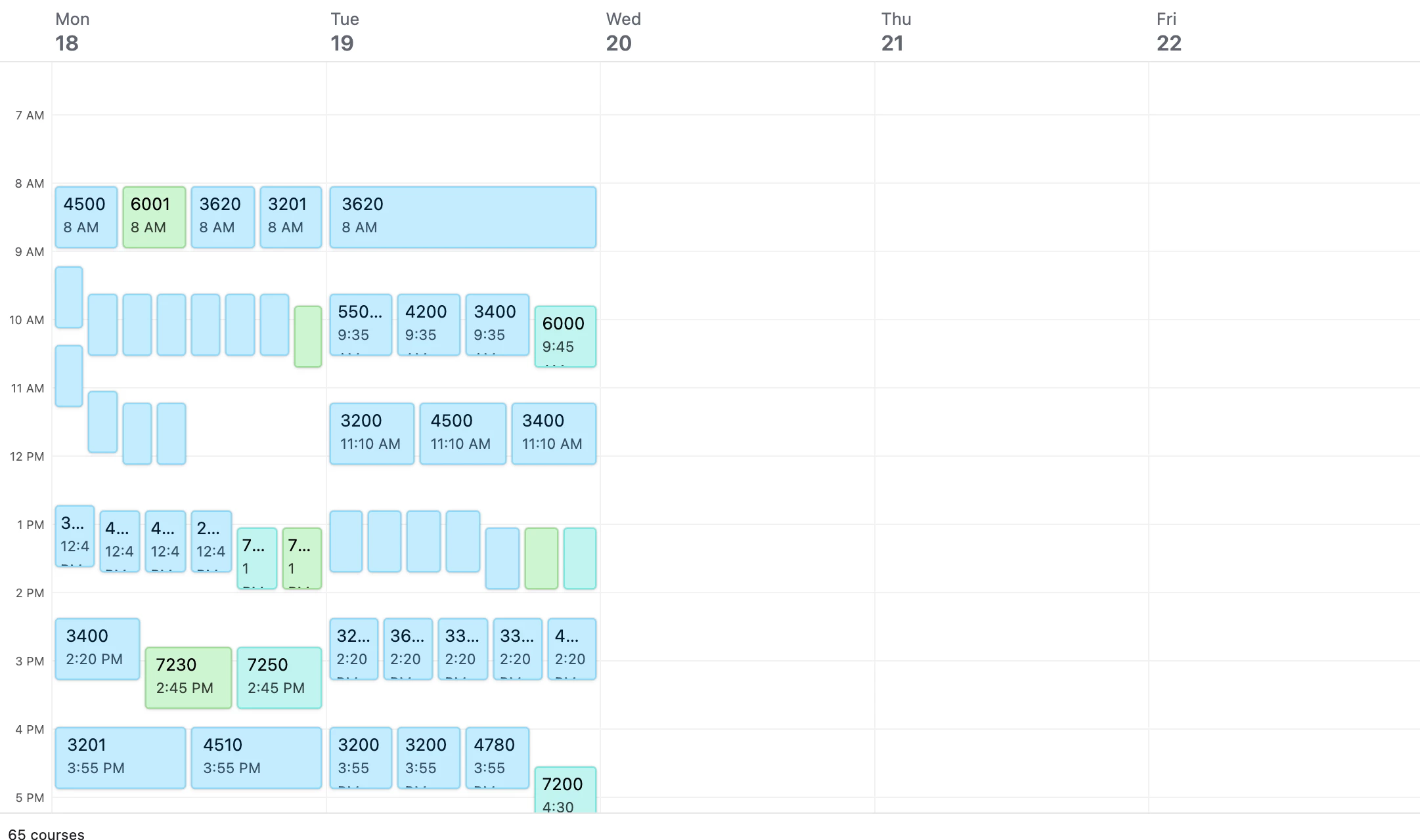

This is the visual that I am trying to reach in AirTable. I am ok with it being an interface, and I made some progress there after your guidance of creating one record per class meeting, although I do not have that nailed fully. The interface in Airtable would look something like this
Although now this is only partial, and only the start times are correct. The end times should be a function of duration (in mins).
Thanks for your help.

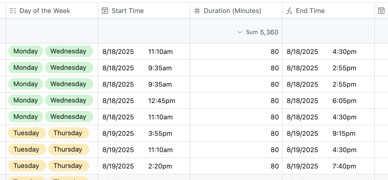

  • July 20, 2025
The data looks like this. As you see, I chose just one date for a session (so it is ignoring the second date), but that is fixable. Also, End Time is a formula but it has some issues with Time Zone that I need to solve.
