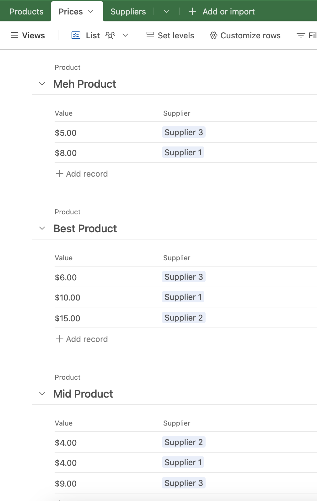

Another alternative way to do this that does not require creating any new fields is to leverage my favorite view type: List Views.
I quickly replicated your data structure and built out a list view that sorts all my price records by the lowest value. From there, all I have to do is set the related supplier to be visible. This is the end result:
It's incredibly slick. Better yet, it doesn't require the creation of any new fields.
Let me know if you have any questions or want a further breakdown of how it all comes together. I'd be happy to provide additional insight.
