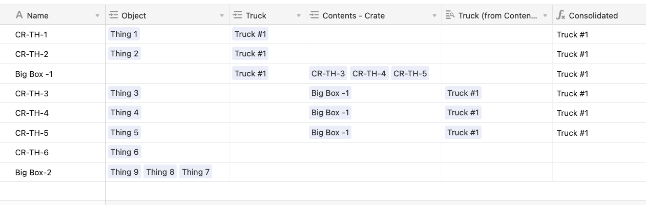

Hmm, off the top of my head, to retain the workflow you’ve got here, I think a possible solution would be to have an automation that runs every time the Contents - Crate field gets updated, and it would run a script that would help you with linking backwards
You could then add a Lookup field and a Formula field to consolidate it all, resulting in something like this:
I think you’d be consuming two automations every time you updated the Contents - Crate field though
Like you said, this seems like it’d be super simple to do, but also baffled me until I settled on just using a script to deal with it. I’m really hoping someone else has a better idea of how to tackle this workflow as well

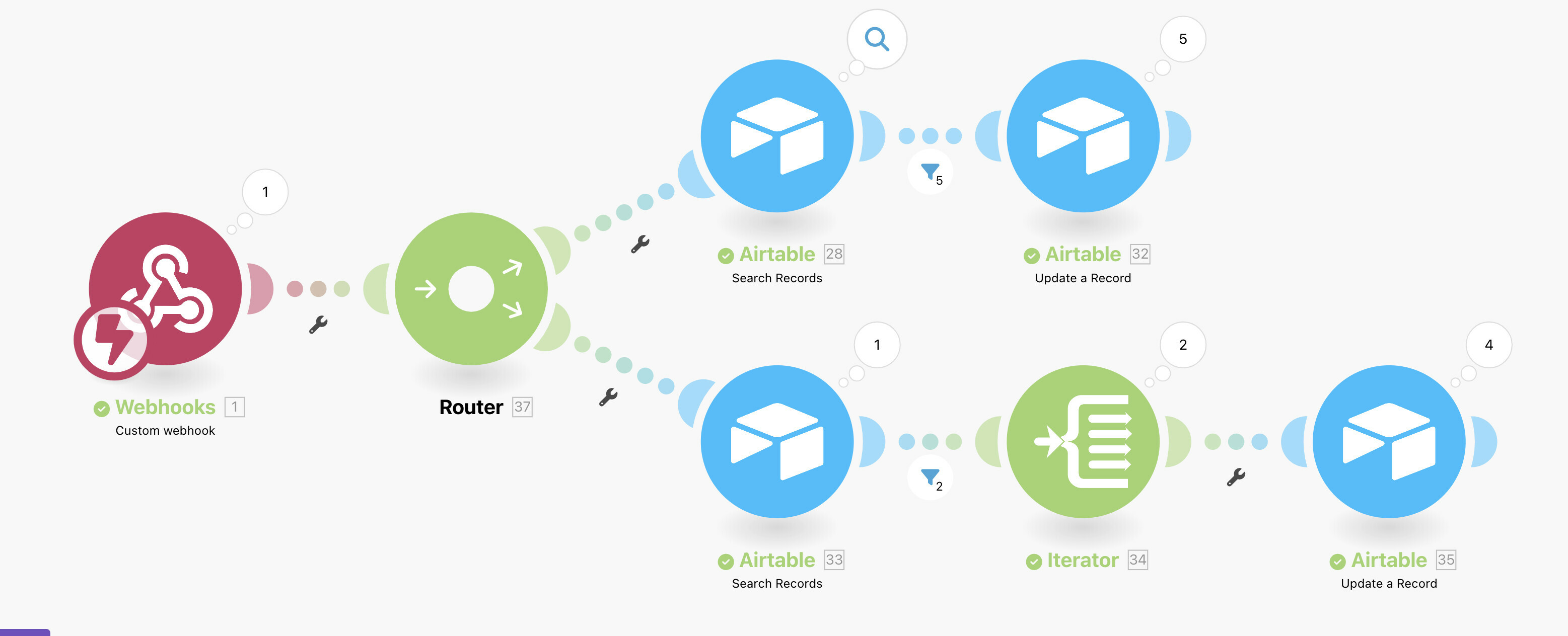

Hi all
Thanks again for your tips.
I think I have got this working now - using Make (Integromat) and automation.
Keen to hear peoples thoughts though. This is how I went about it :
  1. Added a Checkbox field for “Loaded”
  2. Added a ‘flipme’ checkbox field and a button which triggers a script to set ‘flipme’ to true (thanks to someone in this forum for this tip
  3. Added an automation which runs when ‘flipme’ is set to true
The automation then:
  1. Finds all records set to “Loaded” - then runs a script to set them to false. This just clears it all out so we are starting a fresh.
  2. Runs another script which sends a Webhook to Make
  3. Sets ‘flipme’ back to false.
The Make scenario then -
  1. Searches for records with something in the “Truck” field - and marks them loaded
  2. Searches for records with something in the “Truck” filed, AND “Contents - Crate” field, then iterates through those records and marks them loaded. (These are the problematic crates which are loaded into another crate before going on the truck - and caused the problem in the first place as they showed up as unloaded.
I think this should work ok. Doesn’t use too many operations. Only disadvantage is it has to be triggered manually - but that is no big deal. (If it triggered on every change, it would use far too many operations. Same if it triggers at regular intervals).
Keen to hear what people think.
Andrew
