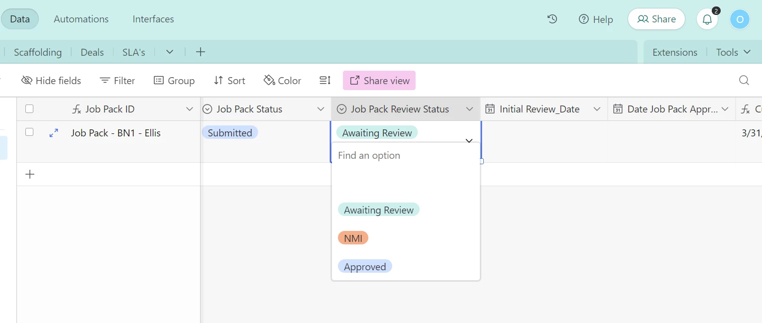

I'm in the process of creating a base which is to be used by our company and an external company to share information and update the status of job packs for solar installations.
Scenario
I have a single select field called "Job Pack Review Status" which contains the properties "Awaiting Review", "NMI" and "Approved". I want to keep track of the time when the external company changes the status to either "NMI" or "Approved" by logging a time stamp. However, there are scenarios where if the job pack may be rejected (NMI) and then resubmitted after being updated. In this instance the status would change back to Awaiting review before the external company makes an update. In this scenario I'd like to keep a second timestamp when the property is updated for the second time.

@TheTimeSavingCo That's an interesting way of going about it. Let me give that a go.
I had thought of having a new submission every time a job pack was rejected and then just having a last updated timestamp for each. I'd then link all the submissions for the back to the main project to count the number of submissions and avg response time. However, I would loose the comments and it would be harder to track the current status.
