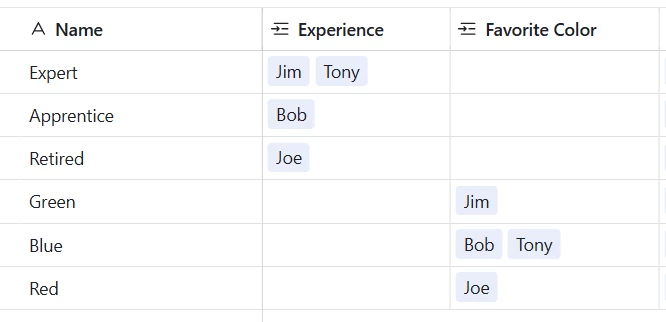

There are ways to do this with scripting and/or automations, but looking at the simplest solution first, if your Attributes table looks like this

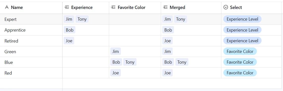

you may be able to get away with creating the new “merged” relationship field and an attribute type single select, and copy/pasting each attribute into the new linked field.
You’d need to copy paste once for each attribute type. I’d maybe filter by attribute type for each operation so you aren’t overwriting previous attributes with blanks.

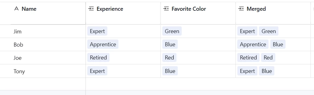

Your people table will end up like this
This assumes a certain simplicity about your data to work.
  • December 17, 2025
Ah, thank you for providing such clear images. This is going to be my last resort as there are 580 rows and thousands of linked users.
I may end up going the automation route, this just seemed like it should be possible with a formula or something given that all the attributes exist in the same field.

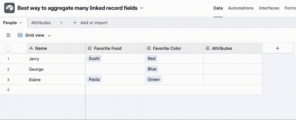

Hm how much work this is depends on how many attribute fields you’ve got, but it should be fairly straightforward:
And to make it cleaner you could filter by ‘Color’ not empty, then copy paste, ‘Food’ not empty, copy paste etc
  • December 18, 2025
This is what I ended up doing, and it worked great! Thanks so much for your help.
