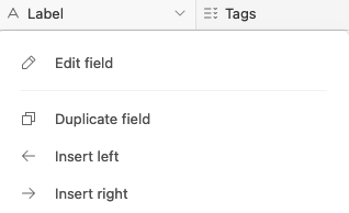

Adding on to Dan's solution: to relink, right click that abandoned field and click "Edit field", then change it to a "Link to another record" field.  Select the table you want to link it to and you should be good to go!

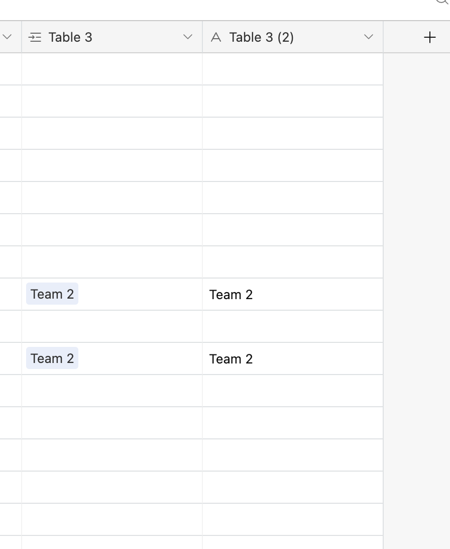

In your "linked" table you should have the abandoned field stillIn this picture you can see the 2 fields that were linked.  I deleted 1 field from "table 3".  The data converted from a linked record to a plain text.  When you relink, you should be able to use that data to restore where the data was linked previously.
