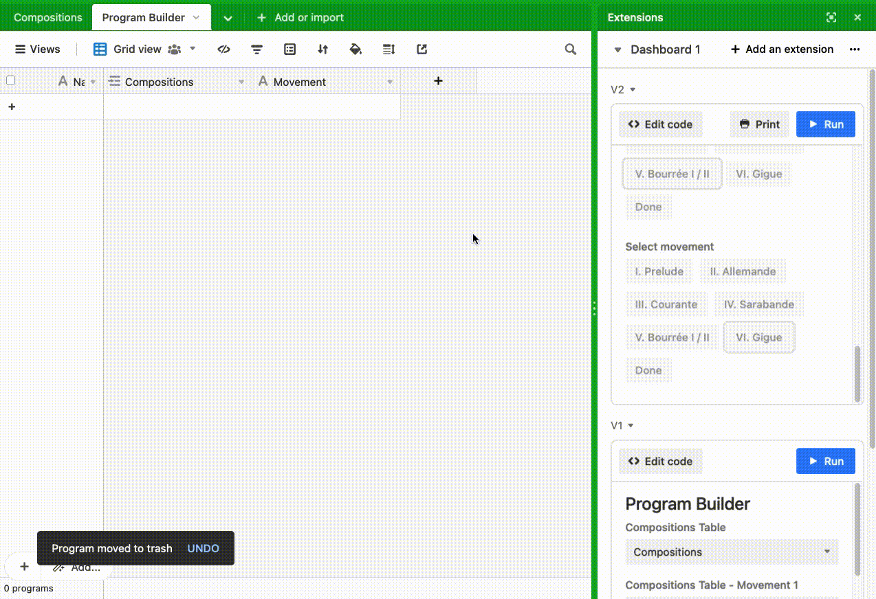

Hi Andrew, yeap that's doable
I've created a new extension in the base called `v2` that should do what you're looking for
