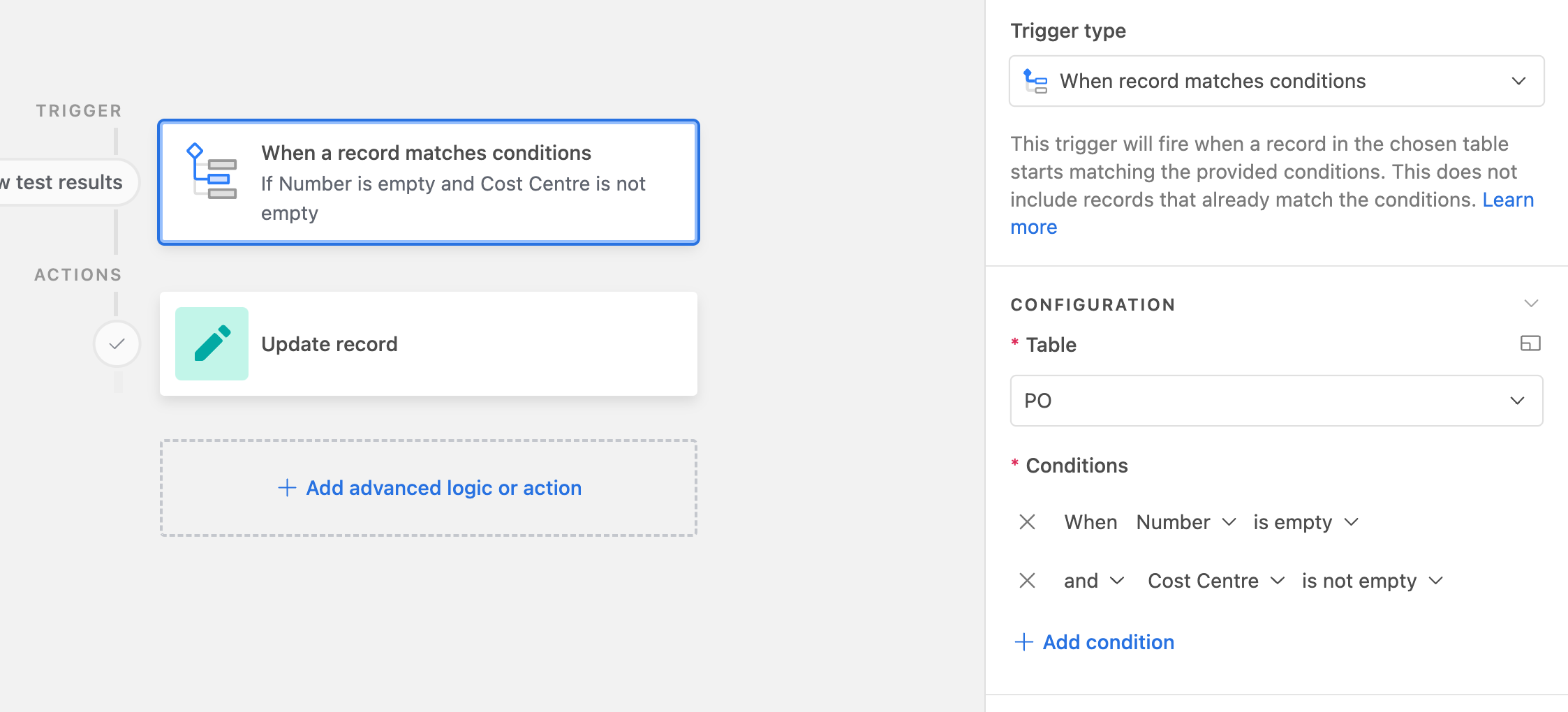

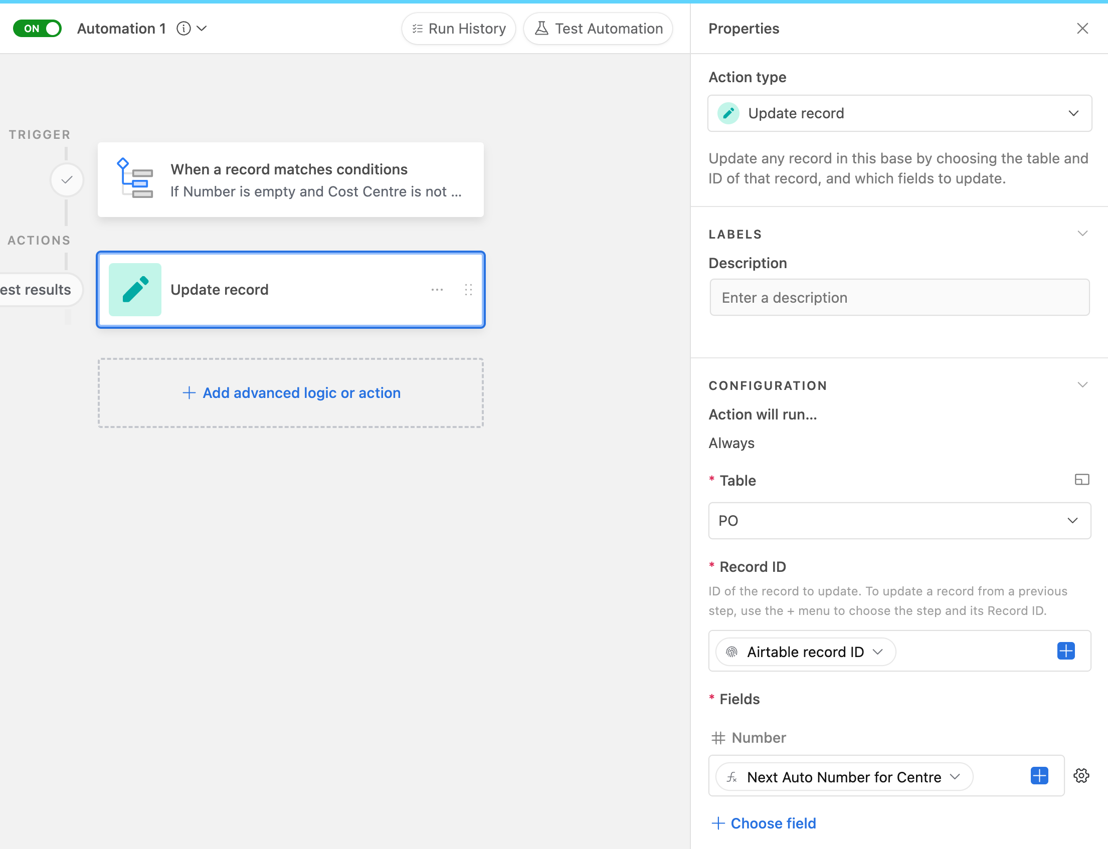

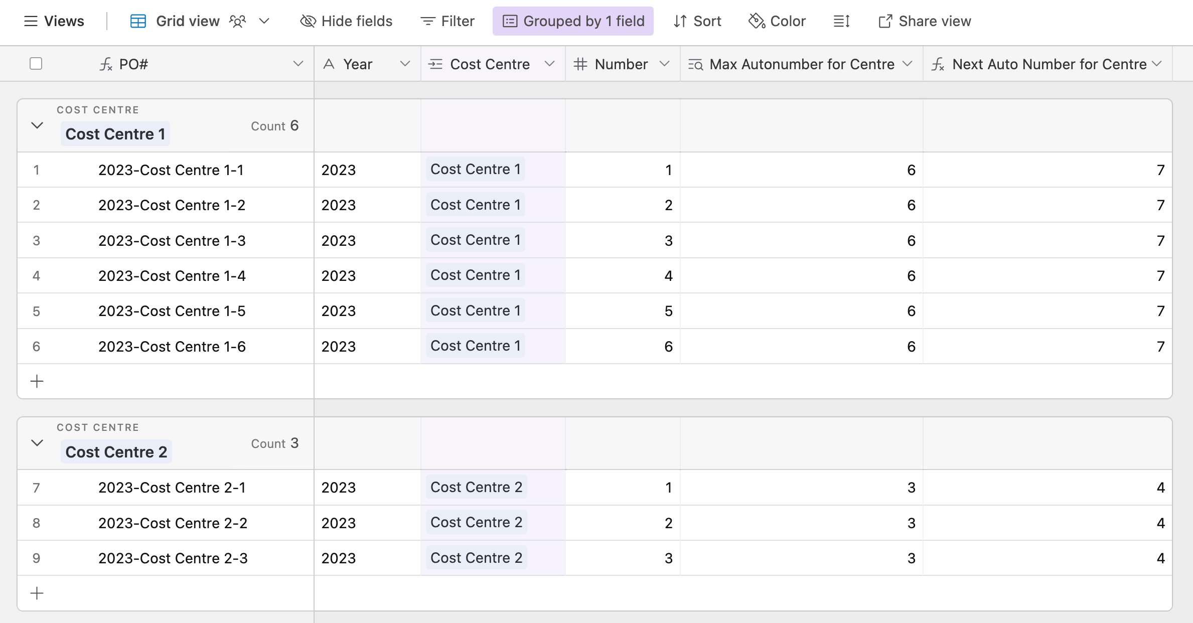

Thank you for your really well structured question. You should be able to solve you dilemma with a creative automation. To set this up you will need the very 1st PO number assigned manually for each cost centre, but from there you can automate the rest! Below is an image of my mock PO table,  my "Number" Field corresponds to the "Number" in your PO number formula.

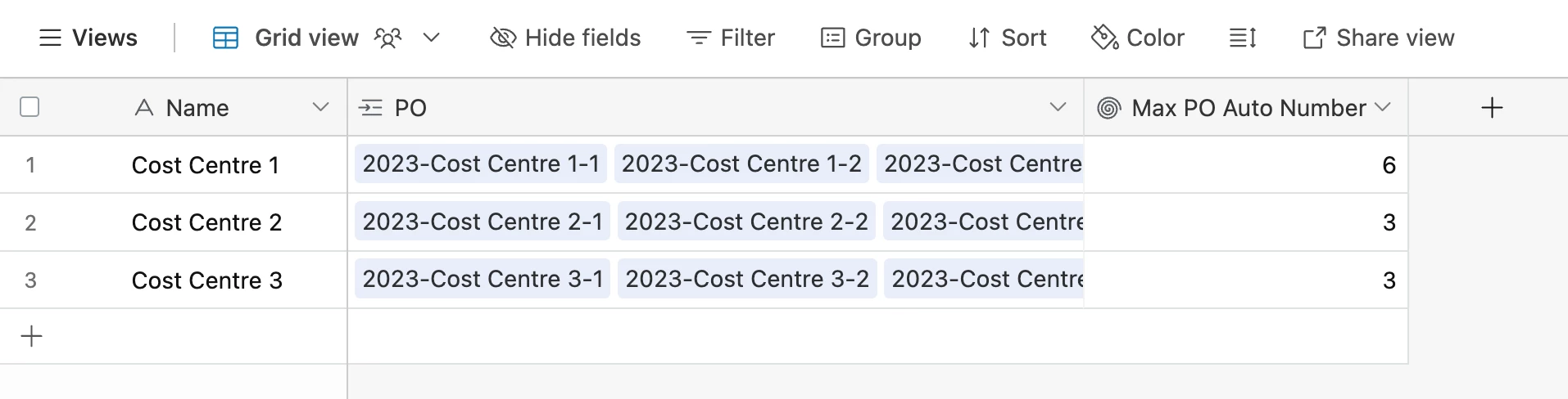

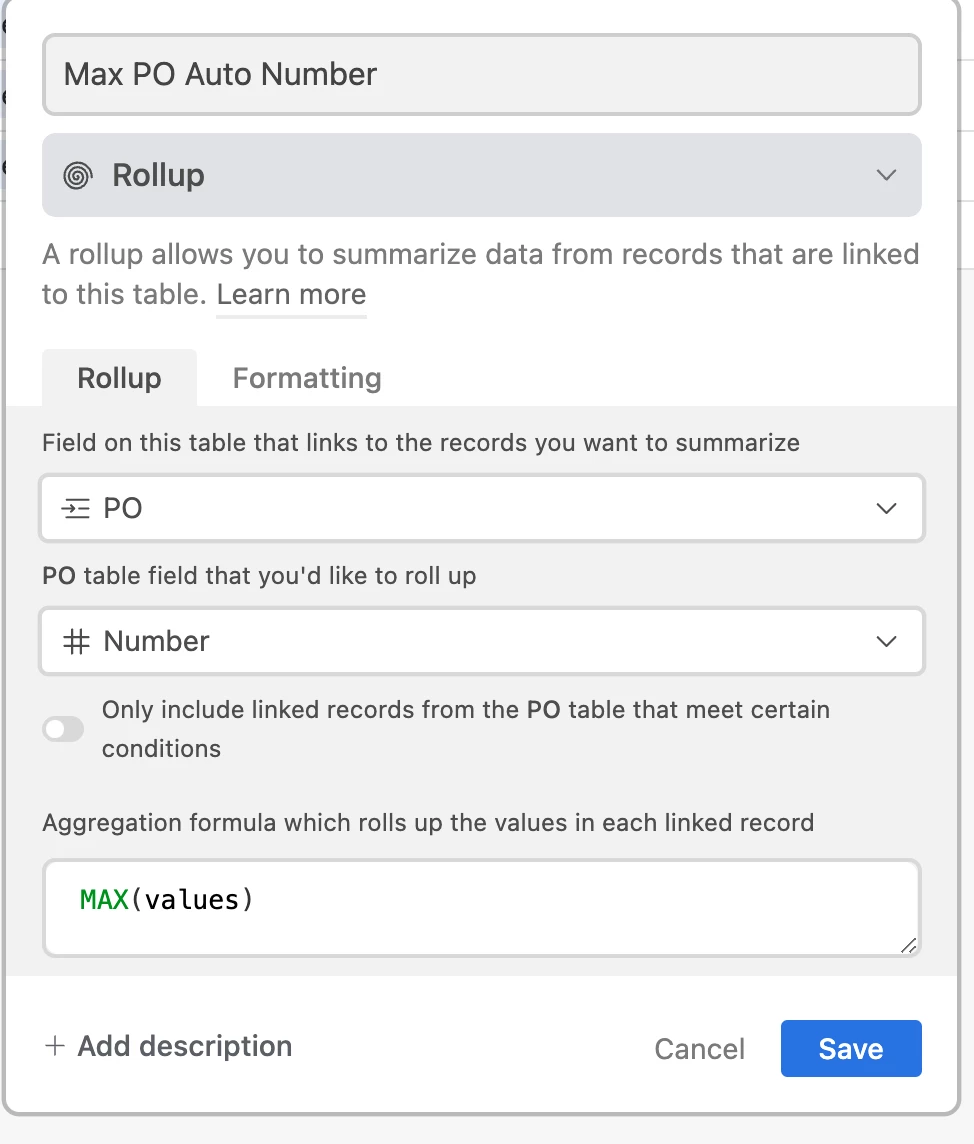

Since you are already linking a cost centre  table you can use a roll up field on that table to tell you what the auto-number on the most recent previous PO is for that particular cost centre.
You can then look this number back up on the PO table and use a formula to calculate the next number in the sequence. In this case for cost centre 1 that number is 7, and for cost centre 2 it is 4.
Now you have everything needed to set up the automation you need. This automation assigns the new PO with the next number in the system in the "Number Field".

Hi there! Welcome to the Airtable Community!

  • March 4, 2023
Wow! This is brilliant. I would never have thought of using automation for this workflow, but I have it all working now.
I thought I was in decent shape having all PO numbers count up sequentially but now giving each Cost Centre its own sequence is an amazing addition. I don't need to reformat existing workflows outside Airtable now as the generated PO number aligns exactly with what we have been producing manually.
As long as my team remembers to manually enter the first number for a Cost Centre, we are set.
