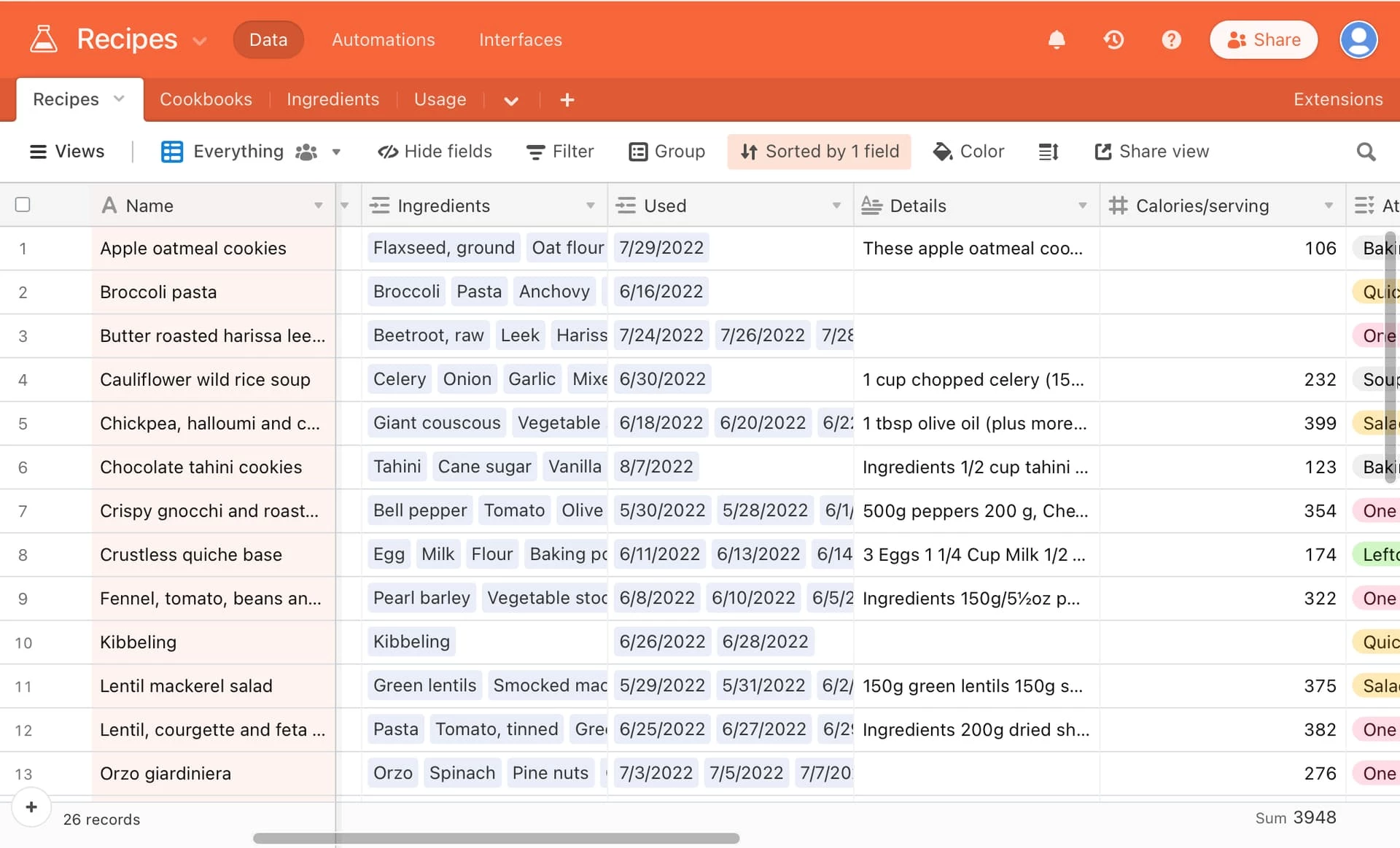

Onto my question. I have a base that I use to record recipes and use as a meal planner. I would like to be able to generate a shopping list from the recipes marked as going to be used in the next week.
In my main table Recipe, are obviously the recipes. I’m using 2 linked fields to two different tables: one for ingredients and one for when the recipe will be used (as that’s the way I found to show multiple dates for one recipe). In the usage table I have a view that shows me the recipes for the next week. I cannot however wrap my head on how I should go to create a view (in any of the tables) that says “show Ingredients matching Recipes where Used date is within the next 7 days”.

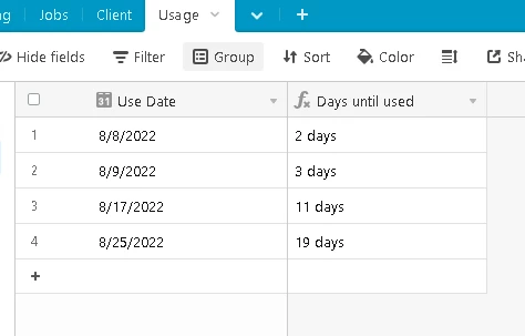

On the Usage table, Add a formula field with
TONOW({Date})
Set {Date} to the name of your Used date. This will tell you how many days there are to that date from now.
Now you can filter to only show Used dates not in the past.

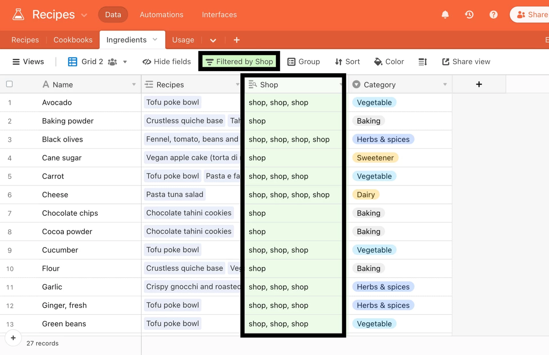

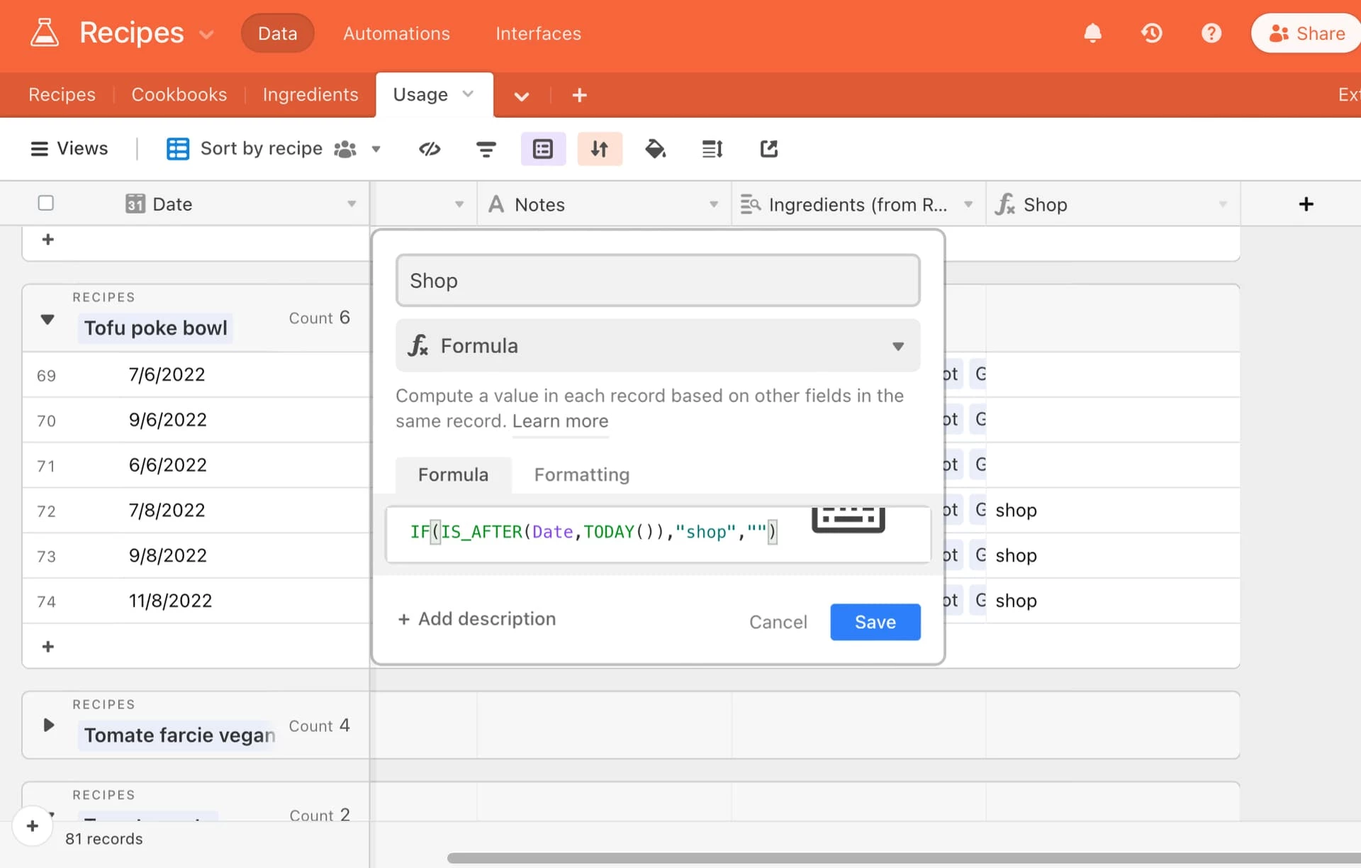

Thanks for the input! TONOW didn’t quite do what I needed as it was just returning a value with no indication if it was in the past or future. However, this out my mind to work again and I have achieved what I wanted. I’m not sure it’s very elegant but it does the trick.
I added a formula in my usage table to return only dates after today.

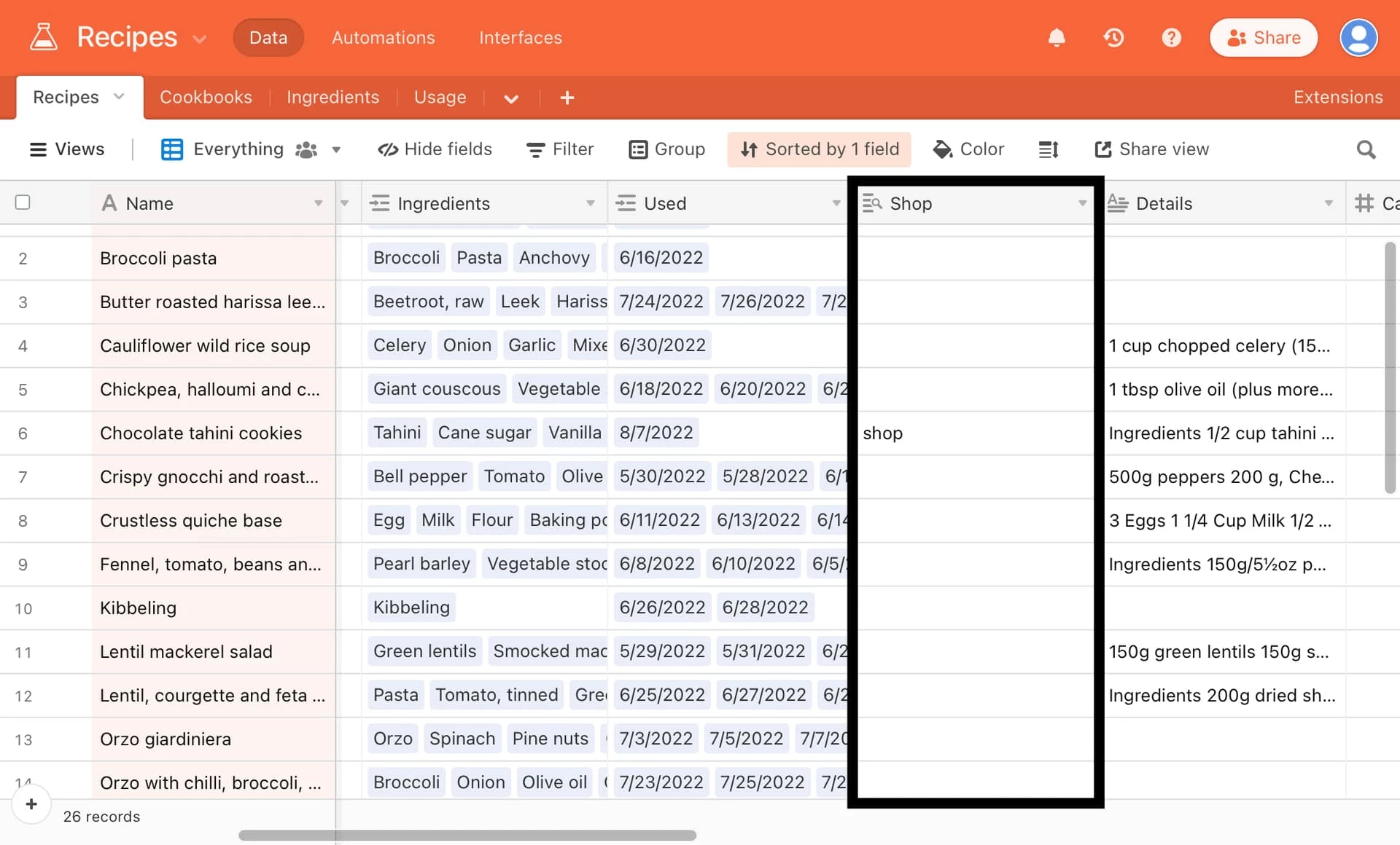

Then I added a lookup field in my recipe table to look for that field.
The in my ingredient table I added a lookup of that field via the recipe table and filtered not empty cells, therefore only showing ingredients needed.
TONOW({Date})
TONOW({Date})
