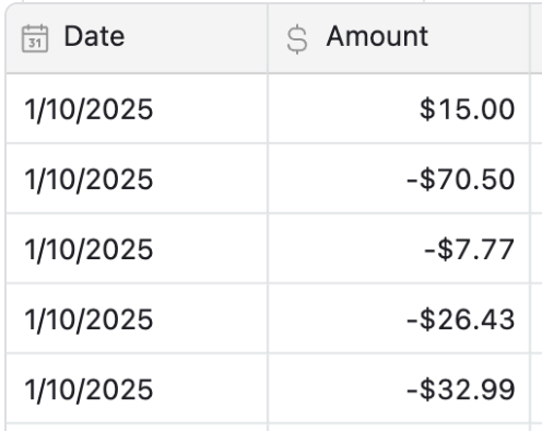

On the import mapping page, the CSV data is being picked up as mm/dd/yyyy even though nothing in my base is in that format. As a result it's confusing the dates and losing half of them.

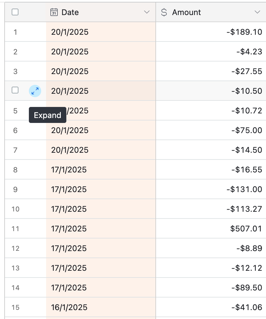

My table:

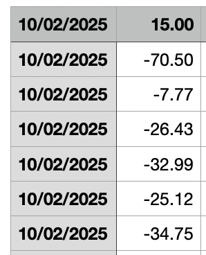

My CSV file:
The import page:
It's not even getting the month correct.

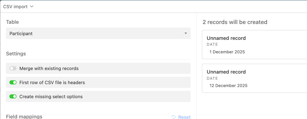

Interesting!  As a data point, I'm using the CSV Import extension and importing into a Date field that's set as 'Friendly', and it shows me this:
And this is my csv:
date 01/12/2025 12/12/2025
 So it looks like we're getting different behaviour here somehow.  Any chance you could send me your CSV file and I could try to import it with the CSV Import extension so that I could test it out?
