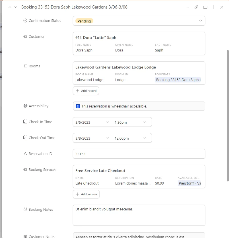

This brings us to our bookings.
I intentionally did this last because our bookings are a structural junction between customers and the rooms.
When it comes to your workflow, you would theoretically map your data import to the Bookings table.
If you're importing data from another platform, then the exact answer on how to do it just depends on what that data export looks like.
Regardless... this structure is robust, it's organized, and your relationships are clearly defined.
Additionally, you open yourself up to some really solid reporting on some of your operational metrics.
I even got a bit curious about what I could drum up as an example, so I added a quick exploratory interface dashboard for you to explore that will show you some of the visibility that you could gain when you trust in the process of clean data.
