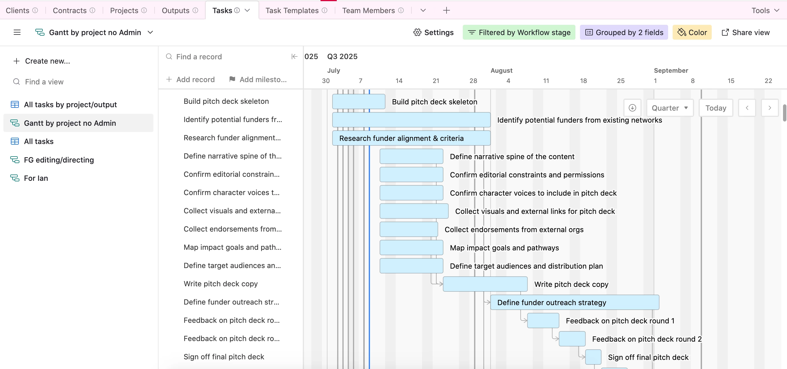

Hi ​@Mike_AutomaticN
I attached a screenshot of one of the projects I’m referring to, in Gantt view. As you can see, some of the tasks are happening in parallel but don’t have the same end date + depend on each other.
I’m very new to the platform, I’m not sure what you’re referring to re automations?
Thanks ​@felipe-saucedo also, ideally I’d like to avoid breaking tasks down any further - I want to keep our view as clean and concise as possible.
felipe-saucedo
Forum|alt.badge.img+10
@SarahVFRF  I get what you are saying but I am afraid dependencies in Airtable only work with end and start
 So A needs to finish to unlock B
