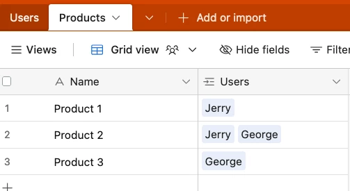

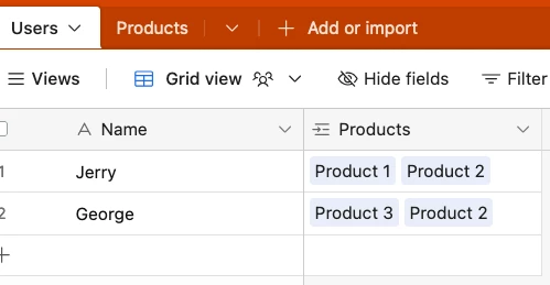

Hmm, after creating the records in Users and Products, I created a link between the two and manually linked them together?  So sorry, I think I don't understand what you're asking

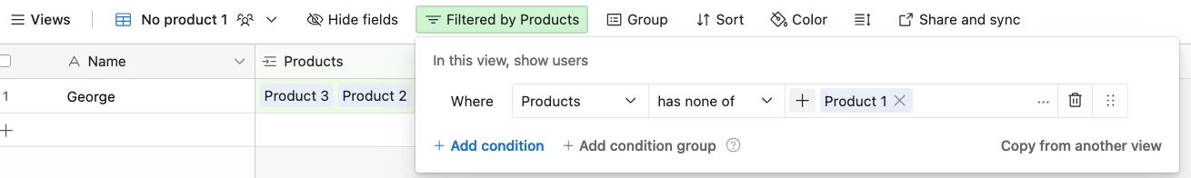

re: Getting a list of who doesn't have Product 1
Ah yeah, you could use a filter for that and I've updated the base with a view called "No product 1":

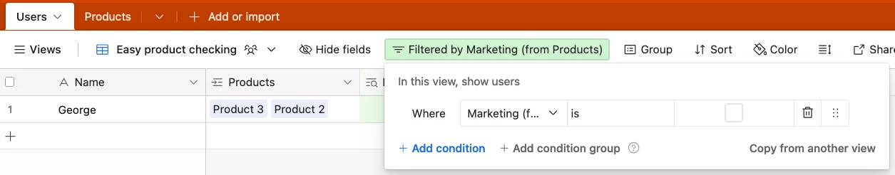

The system above should solve your problem, but filtering like that also seems slightly tedious.  In these situations I also like to use a checkbox to filter stuff and I've created a view called "Easy product checking" for you to check out if you get bored.  When you mark a checkbox in the 'Products' table, this view in the 'Users' table will display users who don't have the marked product

Hmm, I'm not too sure I'm following so I put together something here.  What would be the next step from here?
Thanks Adam that makes a lot of sense, bit of lateral thinking compared to SQL I guess 🙂
