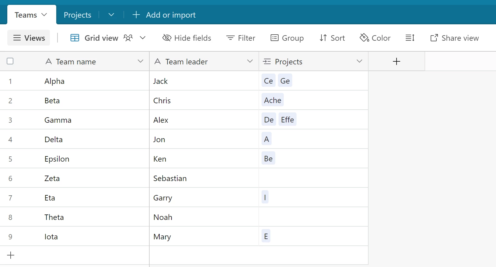

I have a base with 2 tables - Teams and Projects (as shown below).
Every 3 months the leader changes. Now if I update the leader name in Teams table, it updates the leader names in the previous records too in the Project table (because of Lookup). How can I prevent updating the lookup values in the previous records?

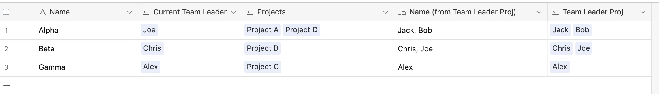

this is the TEAM table where you have the "Current Team Leader" field for your Team that you can change (linked record to last table "Team Leader Proj")

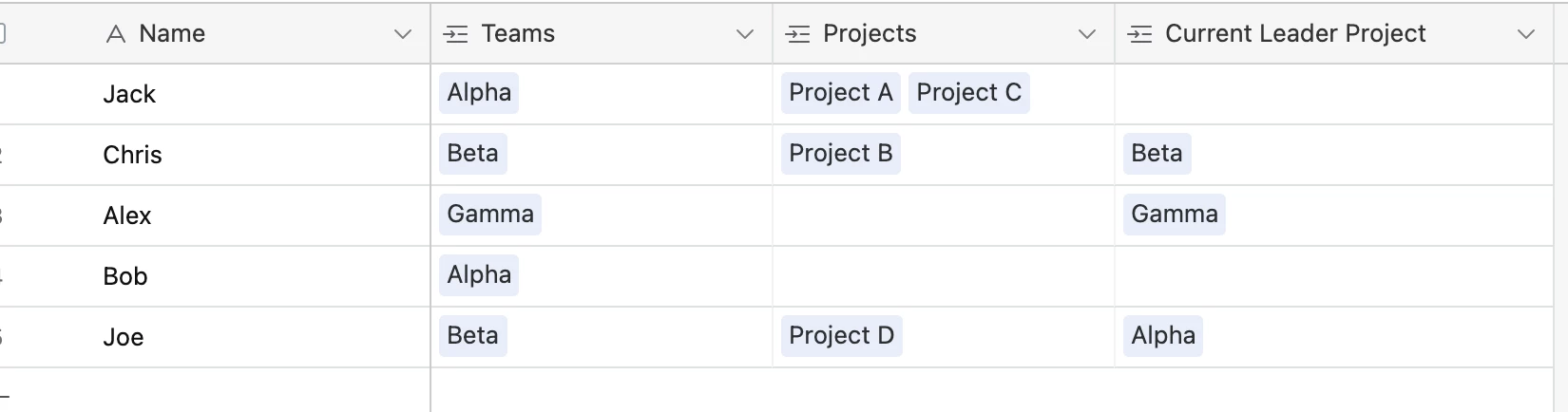

and this is the last table "Team Leader Proj"

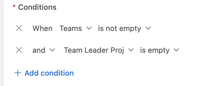

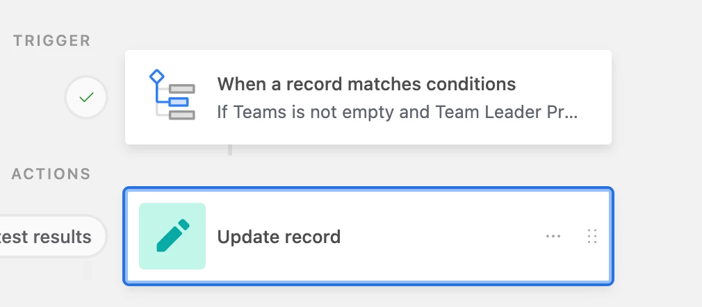

then the you have this automation that as soon as you assign a TEAM to your PROJECTS table update the record of the project with the "current leader" of the that TEAM
these are the conditions:

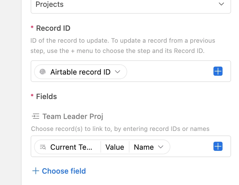

and here you update the "Team Leader Projects" linked field record of the PROJECTS table with the value of the "Current Team Leader (from Teams)"
