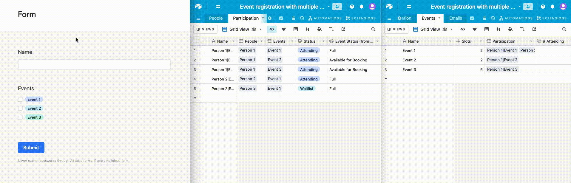

Hi Andre, having that junction table will allow us to automatically track whether an event is full, view payments per person per event, and send emails per person per event
We could…probably(?) do it with just two tables, but it’d get super complicated I think, and would require some manual work such as deactivating events and stuff
I’ve created a working version of what you’re trying to do here with three tables
To view the setup (formulas, automations etc), duplicate the base by clicking the title of the base at the top of the screen, then the three horizontal dots on the right, and then the “Duplicate Base” button.
It’ll automatically update a person’s attendance status based on the number of slots each event has with 3 automations
The first automation will create a record in the Participation table per event the person has chosen to attend via the multiple select field in the form
The second automation links the Participation records to the Events record. This allows us to do a rollup of the Event’s attendance status, i.e. whether it’s full or not
The third automation will update the Participation record’s Status value to either “Attending” or “Waitlist”, based on whether the event is full or not
For the emails, I’ve created another table called Emails that is linked to the Participation table
If a Participation record’s Paid value is unchecked, and the Days since creation / last email value is > 15, then it’ll send an email
Once an email is sent, it’ll create a new reocord in the Emails table that’s linked back to the Participation table, and we do a rollup to find out when the latest email was sent, which allows us to power the Days since creation / last email formula
Let me know if you have any questions!

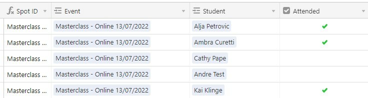

Hi all! this is a great thread!
I am dealing with a very similar base
I have 3 tables: People, Events and Attendance.
The main difference for me is that people don’t register for events, the Attendance table is currently manually updated after each event based on who shows up. It’s a very tedious process to enter records in the Attendance table considering there are 150 people and 24 events per year.
Do you have any idea how I could pre-populate the Attendance table with all eligible people for each event? After that for each record I will simply update an “Attended” checkbox, much faster than entering all info from scratch. (See screenshot)
I tried with automations but they don’t support bulk creation of records…any other idea?

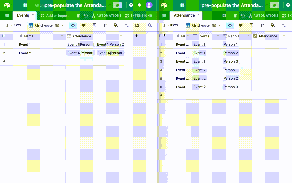

Hi Ambra, I’ve created a base that should solve your problem here that works on the same principles
A word of caution: It features an automation that will run per record created in the Attendance table to link each one to the respective People record, and so you might burn through your automation runs really quickly.
You could do this manually by just copy pasting the Person Name column values into the linked field, or if you find you do not need the link to the People table at all you can do away with the automation entirely
Do let me know if you have any questions!
