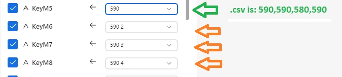

Hello,
I am importing a csv file formatted: 390,390,390
The table does this: 390 390 2 390 3
It's including the number of 390 values in the import file
How will I fix?

I did, this is the csv string: 320,390,390,390,480,590,590,590,590,
Please review attached

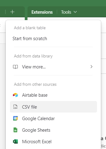

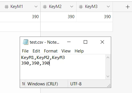

Do you need to create a new table or import new data in the existing?
I'm used
and it's quite simple.
but if you need to use Extension to add data to existing table, you should include field names as a first row

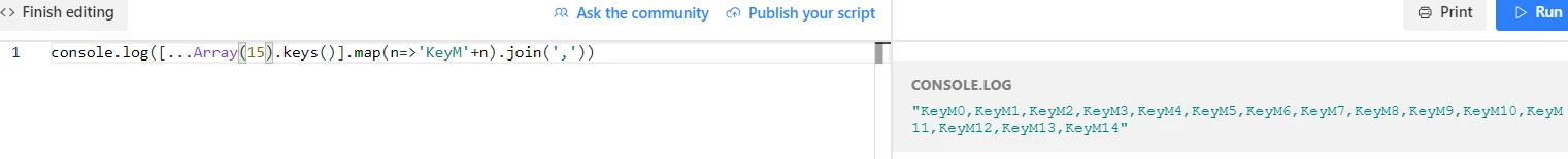

You can use this code to generate if you have a lot of fields
console.log([...Array(15).keys()].map(n=>'KeyM'+n).join(','))

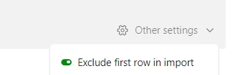

of course, this should be enabled

Can you tell me where the green toggle is located.?

I thought you used extension because usual add table function has no Field Map details like in your screenshot.
Now it's clear. I never used Import Data but it's almost the same as Import with Create new table.
Import function must know which field to use for which number, and it reads first line of csv as field names.
So, CSV must contain several lines and first is field names
And since field name must be unique, it adds extra numbers 2, 3 etc
Easiest workaround is to duplicate line in CSV, to have it like:
and then in options select
The alternative solution is to Download CSV (in View menu) and use list of fields from it.
