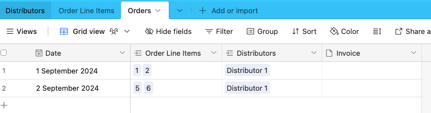

I ended up creating a table called "Orders" that linked the Distributor to the Order Line Items so that we could contain the invoice and date of the order instead of duplicating that data for every Order Line Item:
Thank you!!! This is super helpful and I think may be just what I was looking for!

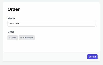

Hannes from the miniExtensions team here! Our form gives you the ability to add multiple records to a table using linked record fields. Your staff could add each order with one form submission. Within that submission, they add each item in a linked record field. This would create separate records in the linked table(s) as needed. I'm not sure what the best way would be for you to then have the receiving staff member use this data. They could either access the original order record (which has the linked records for the individual items), or they could access the list of items to check off what has been received. It sounds like the former may be a better fit for you, but the latter could be achieved with our shared view extension.
You can try all of this out with a free account now! 🙂
