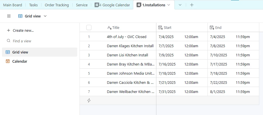

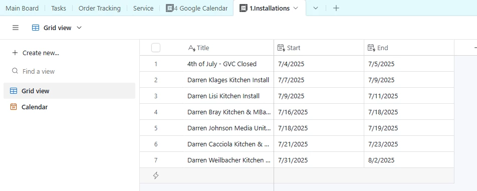

We recently updated our AirTable interface to sync directly with our google calendar. We deal with scheduling out many projects across multiple calendars with subcontractors and we use all day events to do so. When I tried to sync our calendars without incorporating times, all of our all-day events were extended out by one day (ex: All Day Event on 7/8/25 in Google Calendar would translate to Start/End: 7/8/25 → 7/9/25 in AirTable when times are excluded). I’m assuming that this stems from Google Calendar and AirTable having different “all day” time functionality. Is there a way to fix this? Here is the result I’m looking for:

GulfViewCabinets
Hi Scott!
Thank you so much for taking the time to look into this for me!
I just checked out your recommendation. It looks like I’m only able to change time zone settings if I have Times enabled on my date fields. I looked to adjust them once Times were disabled and didn’t see the option to.
I’ve attached a few sample screenshots of what I’m getting…
Before I disable Times...
After I disable Times…
Is this the result you’re getting?

Ah, very interesting… I’m getting the same exact results when I turn off the time!
As far as I’m concerned, this is a bug because an all-day event does NOT end on the NEXT DAY. It ends on the CURRENT DAY.
If I were you, I would definitely open up a support ticket with support@airtable.com about this. But be forewarned that even if they’re interested in solving this issue, it could be months (or years) before they feel like it is a high-enough priority to fix.
In the meantime, you could do 2 things to workaround this issue:
  1. Leave times turned on, although that would get very annoying on the calendar view.
  2. Your best long-term solution would be to create a formula field that figures out what the REAL END DATE is supposed to be, and then use that field on your calendar as the end date. (And you will also want to turn OFF the time in this formula field, too.)
    Your formula for your new “REAL END DATE” formula field would look like this:
    {All Day},
    DATEADD(End,-1,'day'),
    End
Hope this helps!
