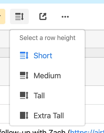

Hiya. Here, could you set up the projects table to have two linked record fields – one for active projects, the other for inactive projects – linking to the staff table? Then, from the staff table, you could easily see all the active projects each staff member is working on. (Setting the Staff table’s row height to Extra tall would help as well.)
