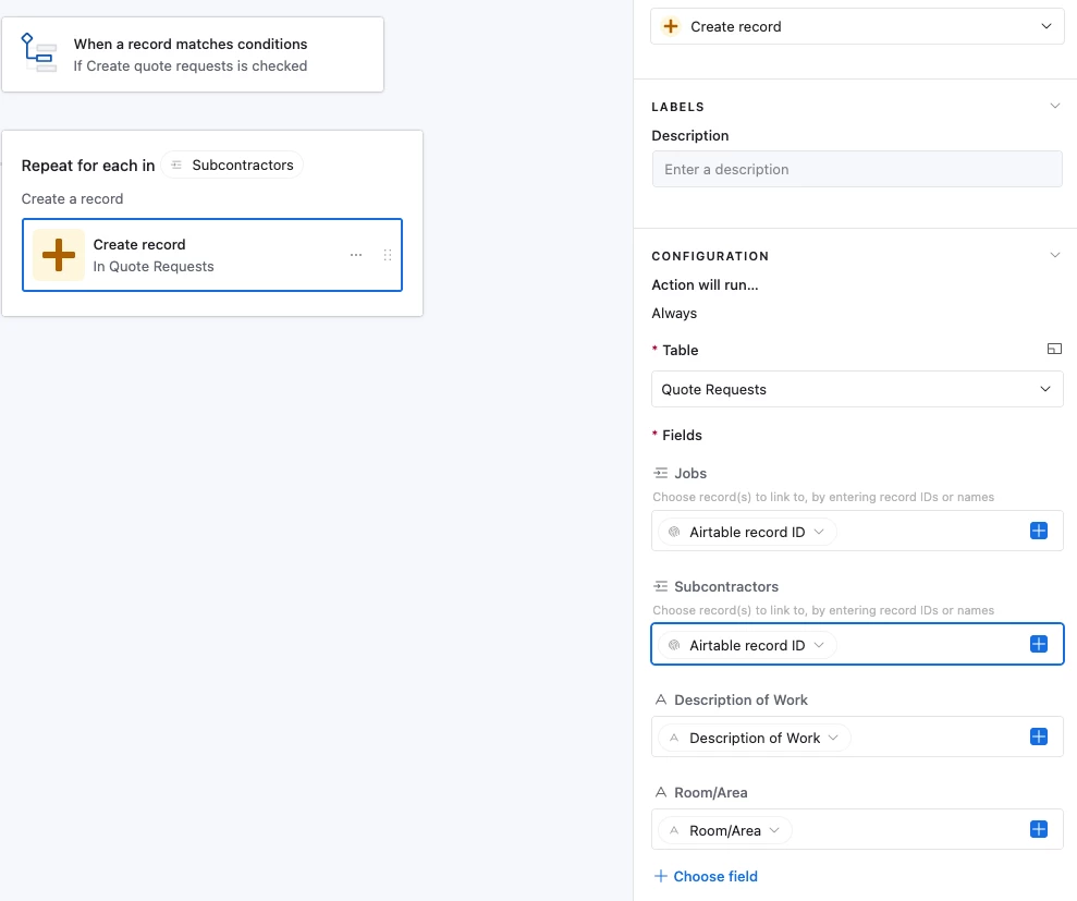

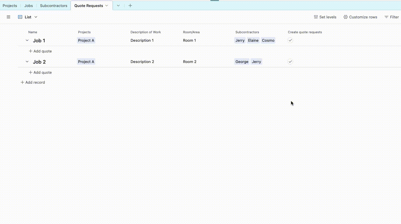

Does this look right?  If so I’ve set it up here for you to check out
This is all handled within Airtable, and this is what the automation looks like:
