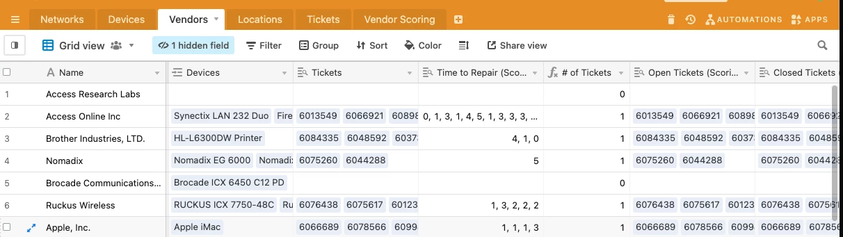

I’m trying to create a scoring system of each Vendor by looking at their total number of tickets and the average time to close/repair a ticket. But I can’t seem to find a way to pull this information via the linking schema I have set up here. I thought about scrapping the Vendor Scoring table altogether and just do the calculations in the Vendors table, but I’ve had no luck there either. I can’t even get the CountA formulas to properly tell me how many tickets each vendor has total (let alone open vs. closed).

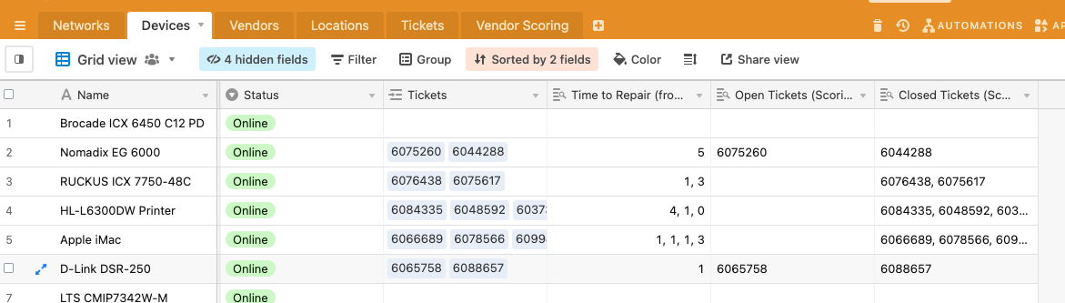

See screenshots below:
I don’t know why I can’t get those Open and Closed Ticket lookup fields to be clickable like they are in the Tickets column?
I can’t get the Open and Closed Ticket lookup fields to properly display the tickets that are actually closed and open. I also can’t get that count function right for the life of me.

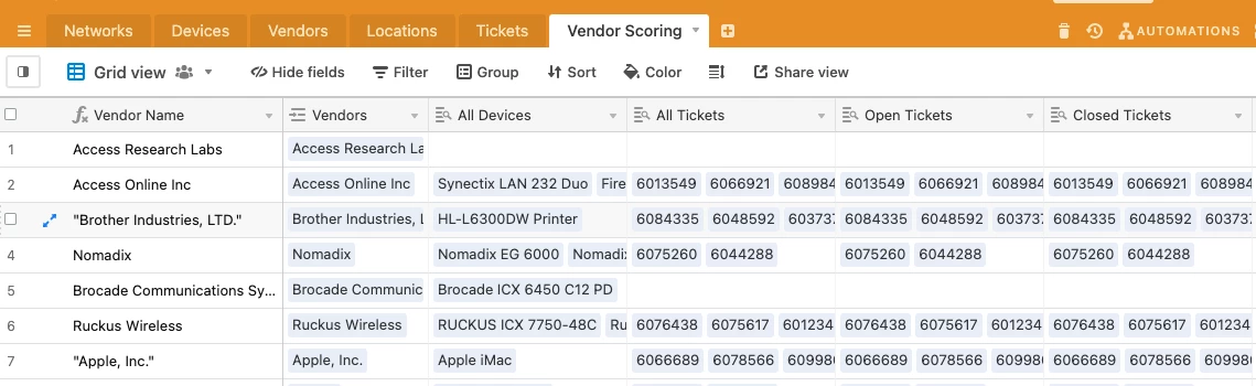

Finally, here’s this mess. I wasn’t even sure what to make the primary column so I just had it mirror the linked Vendors. Again, I cannot get the ticket lookup fields to pull the correct data.

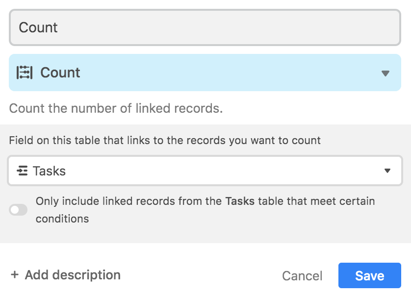

  1. Can you use the Count field type to count the Tickets field (like the image below)?

Nice to see you again on here! I actually hadn’t tried the count field type, it didn’t quite work the way I originally planned - but it did kick me off in the right direction to figure it all out (for now at least!)

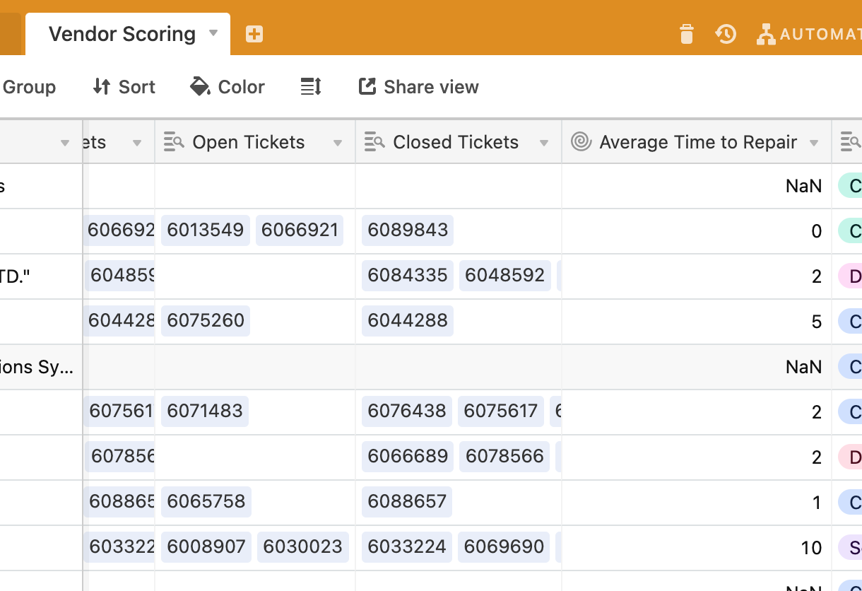

Another (more aesthetic than anything) question, is it possible to get rid of these “Nan” field results from calculations?

As for the “NaN” values, I tend to lean towards an “if” statement using either “0” or “blank()”, depending on what is needed.
