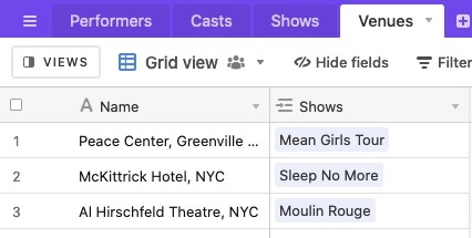

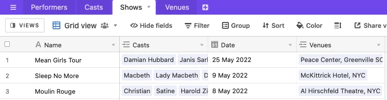

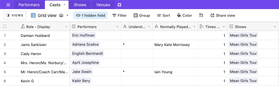

I’ve put something together for you here. You can duplicate the base by clicking the title of the base at the top of the screen, then the three horizontal dots on the right, and then the “Duplicate Base” button.
I felt that there were four sets of data in your sheet, and so created four tables to categorize them
  1. Performers
  2. Casts
  3. Shows
  4. Venues
Each performer is linked to a Role in the Casts table, and each Role is linked to a Show, which is in turn linked to a Venue. Having Shows as a separate table allows us to add the date of the show itself and venue, as well as any other data of note. I’m not sure whether there’s any additional data you want to key in for each Venue, in which case, we could simply convert the Venue linked field into a single select field instead.
