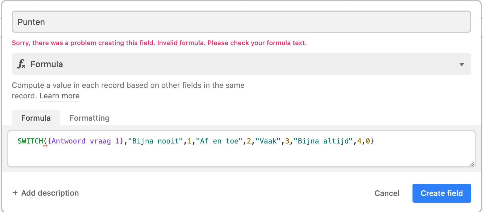

Hi Christian,
Thank you for the quick response. I tried it and I get an error prompt (see attached file). Am I missing something?
You are missing the end parenthesis. The hint is the little squiggly line under the front one. Otherwise it should work.

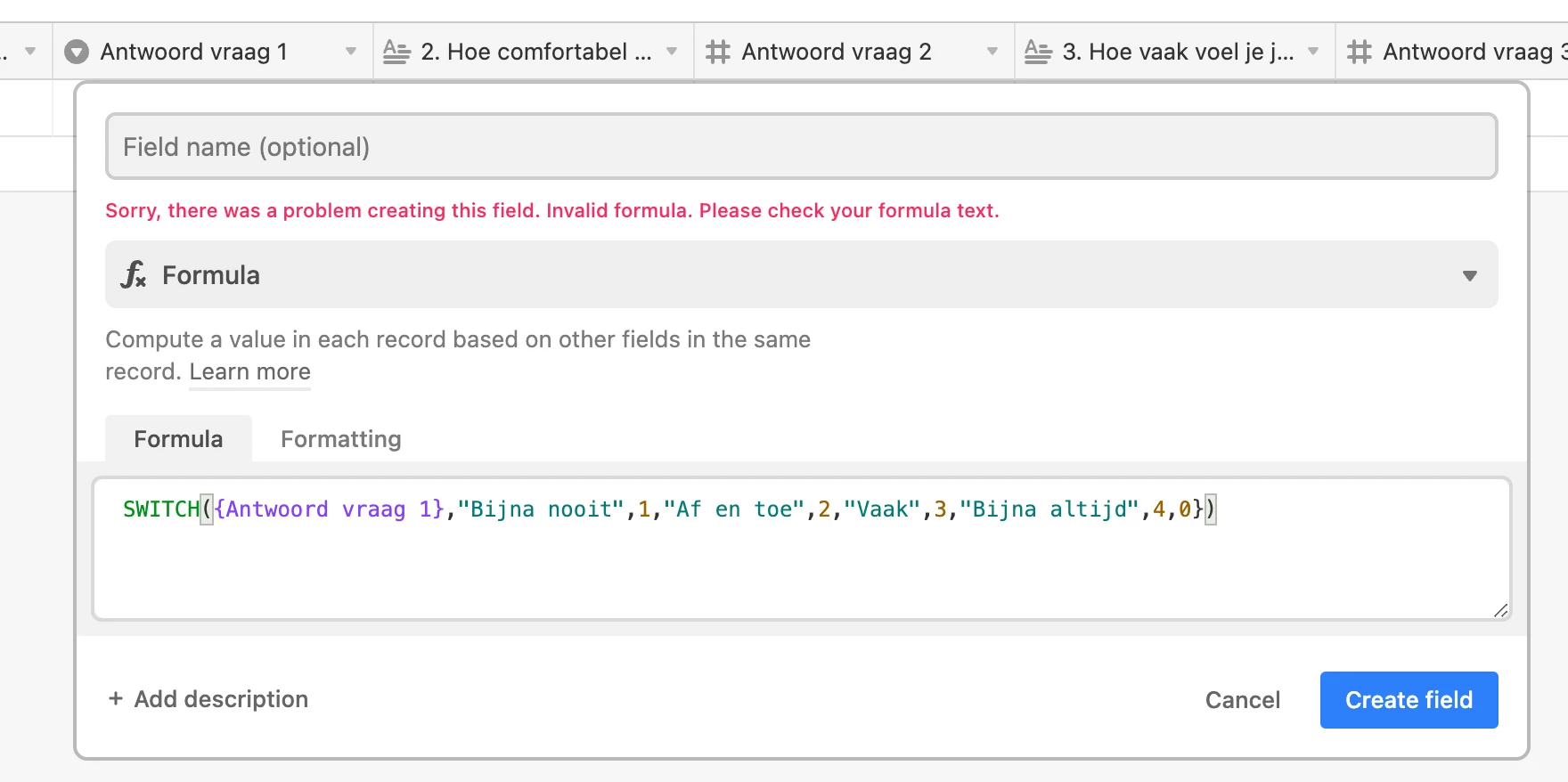

  • February 16, 2023
Now with the end parenthesis added it does not seem to work.
Oh, It's the closing bracket that's extra now.
SWITCH({Answer field},"Answer one",1,"Answer two",2,0)
  • February 16, 2023
Yes! It works! Thank you so much Christiaan.
