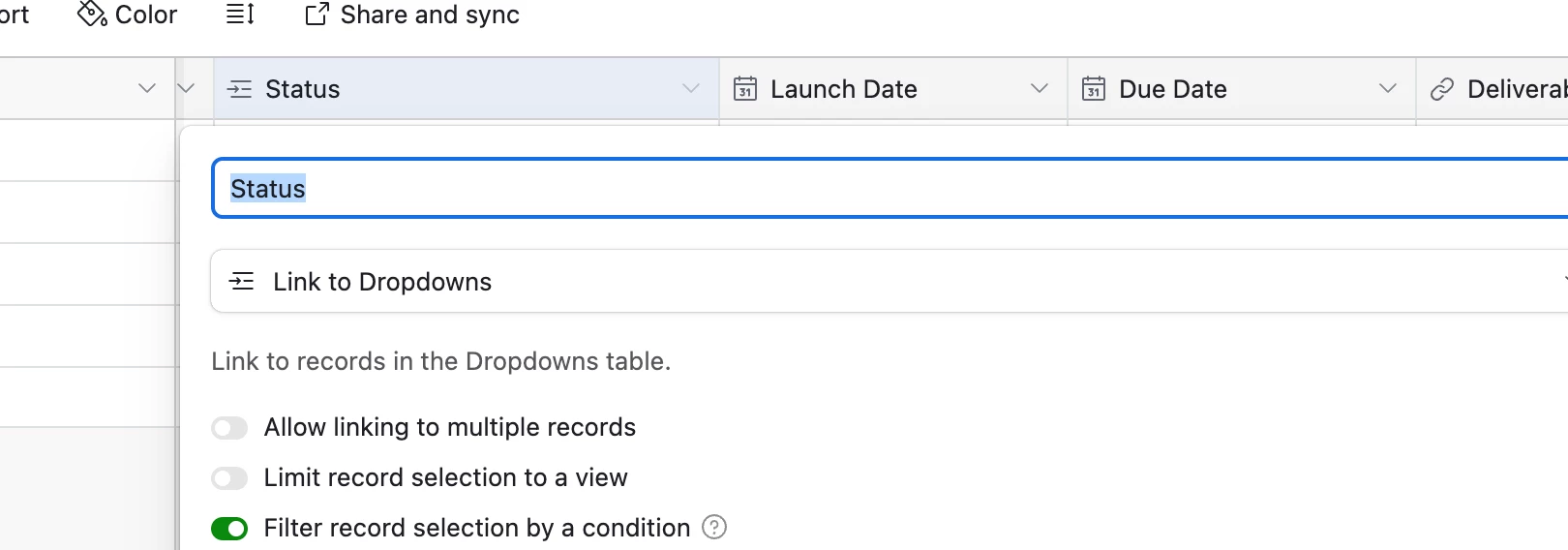

Do you mean that Status dropdown should be dynamic depending on the task?
If so, you’ll want to have the following tables:
Task Templates
Status Options
Link the above tables, and have individual records for Status Options, linked to the corresponding Task Template.
Now, on your regular Tasks table you;ll want to have a link to Tasks Templates, and to Status Options.
Status Options will work as if it were a “single select” field type.
Then you’ll want to apply dynamic filters to your Status Options linked record, to make sure that it will only show those statuses linked to the template tasks through the Status Options table.
I know this was not super detailed, but I hope it helps. I’ll try to get back to it tomorrow!
Feel free to schedule a brief call if you’d like us to go through this together on the spot. Happy to help out.

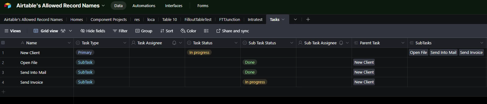

Lots of different ways to build this, but one question that both Adam and Mike are trying to get at is Are you using 1 table for both Tasks and Subtasks?
If you’re using one table with a Parent/Child relationship between tasks and subtasks, you could of course add new columns only for the subtasks (Subtask Status & Subtask Assignment), perhaps with a different interface or view so they don’t get confused with the overtask.
The other option is to utilize multiple tables, with linked record fields between them. so you have a Task table, and a Subtask table which are linked together. Depending on how consistent your Tasks are, you could set up automations to automatically create the relevant subtasks too.
Here’s a SS of the single table solution

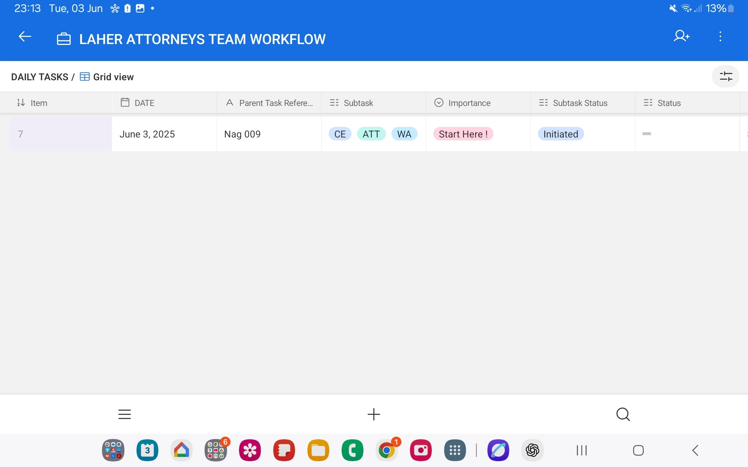

Thanks, it's a single table.
The setup is a drop down multiple select for each subtask- reason is I have about 30 daily parent  tasks with a minimum of 2 subtasks.Having each subtask as a separate line item would leave me with a minimum of 90 line tasks which will be hard to work with.

Yeah, the subtasks need to become data objects that can have their own attributes.
If you want to keep it in the same table but not have it be overwhelming, you could create views or groupings to make the information digestible, but really creating a subtasks table with linked records would probably be best.
I’d create a subtasks table with a formula field as it's primary field and include a single select with your subtask types. Write the formula field to combine the Parent Task Reference field from this table with the Subtask type so the record titles end up like “Nag 009 - CE”, “Nag 009 - ATT”, etc. Then you can assign different collaborators different subtasks and they can have different status.
For an example of this in action, if you look at the pre-built “Project Management” template, it works similarly.
