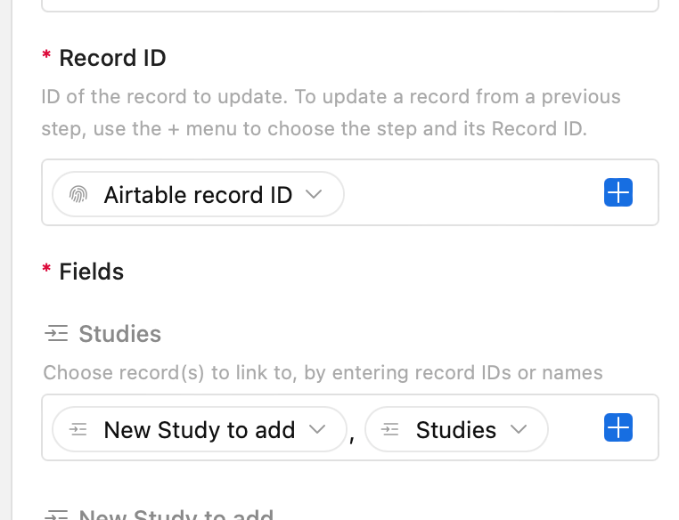

Best answer by Dan_Montoya
hi @Gargazaur ,  I would use an automation.
fields:  linked records of studies, linked record of new study to add.
Automation:  When field new study to add is updated, update the same record using the old values of linked records of studies and the new linked record of studies

Hi Dan,
Thank you for the reply! I'm going to go try this out right now and let you know if it works out!
I actually have a few fields that would use this same workflow, as we track "Reserved for study" which moves into "Contacted" which then goes to "Participated". So I think I can make this same automation twice to move the data twice? And the "new study to add" field is meant to be cleared out each time with no consequences, since it being updated to blank would trigger the automation to update to the old values + nothing, so no change! Am I understanding that right?
Very excited to try this out, will update to "Accept as Solution" as soon as I can confirm.
Update: Works great! I even added a step to auto-clear out the "New study added" field right after so I don't have to do that either. 🙂
Thanks again, you are very appreciated!

There should really be an "IF" statement that if it isn't empty use the 2 values with the comma.  If it is empty only use the new value.  That way you don't end up with random commas.  (Not sure you would but it is a more defensive way to code it.)

You should be able to do that with one automation by making the "new study" field empty in the update step.
