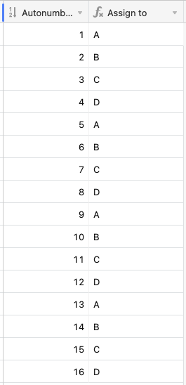

Hmm, I’ve put something together for you here that will assign each record equally between four people
And the formula is:
  MOD(Autonumber - 1, 4) = 0,
  "A",
    MOD(Autonumber - 2, 4) = 0,
    "B",
      MOD(Autonumber - 3, 4) = 0,
      "C",
        MOD(Autonumber - 4, 4) = 0,
        "D"
And the formula is:
  "A",
    "B",
      "C",
        "D"
