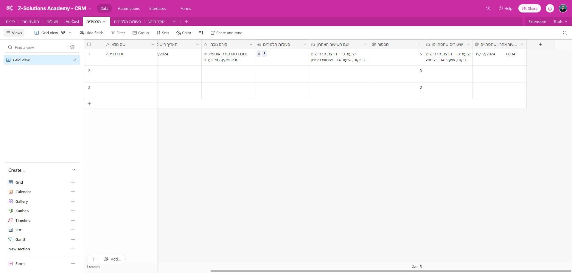

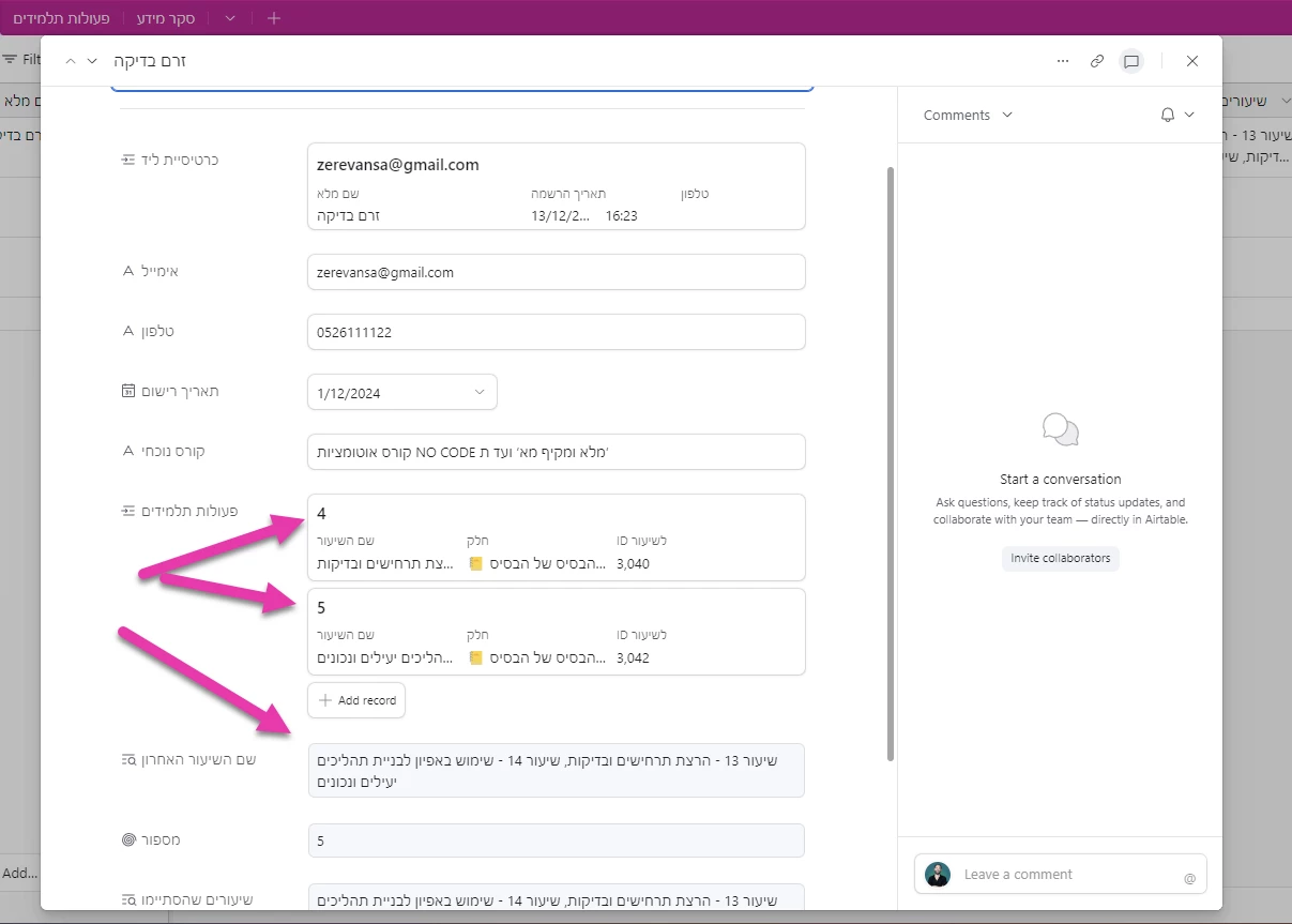

Hi friends, I would appreciate your help with something that I have been stuck on for too long..
I have 2 tables -
1. Students
2. Student Actions
In "Student Actions" I see all the lessons that the students have completed.
In "Students" I see the student's status - both his details and I also want to pull the last lesson he took, the date of the last lesson, etc.
I was able to use ROLLUP to pull the date of the last lesson, but no matter what I did and what I tried - I was unable to pull the name of the last lesson he completed.
Now it seems like something very simple to me, because I need to pull the name of the lesson whose "Autonumber" is the highest, regardless of the date.
I was unable to do this and it is really frustrating.

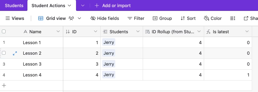

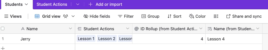

Try:
1. In Students, create a rollup field with 'MAX(values)' to get the latest autonumber
2. In Student Actions, create a lookup field to display the field from step 1
3. In Student Actions, create a formula field to check whether the lookup field's value is equal to that record's autonumber
4. In Students, create a lookup field to display the name of the lesson, and give it a conditional to only display from records where the formula field from step 2 is positive
