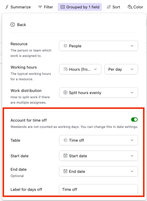

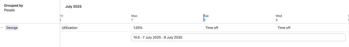

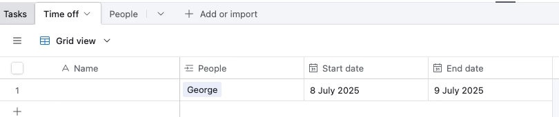

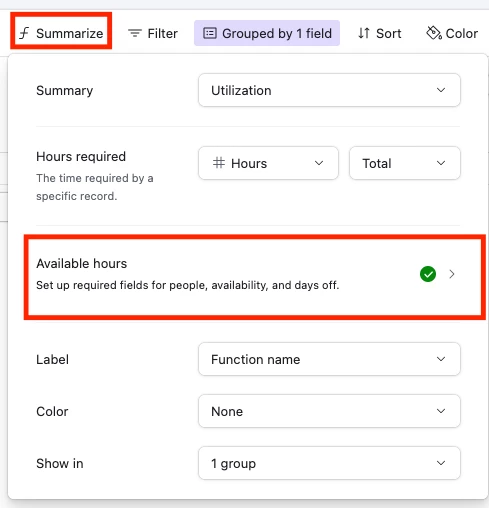

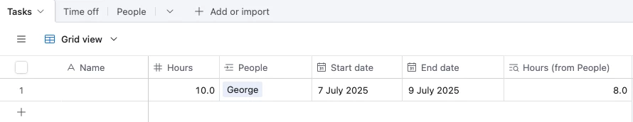

Hm, try toggling on the ‘Time off’ function?  It should do exactly what you need
https://support.airtable.com/docs/timeline-view-resource-allocation
And this is how it looks, and I’ve set it up here for you to check out
